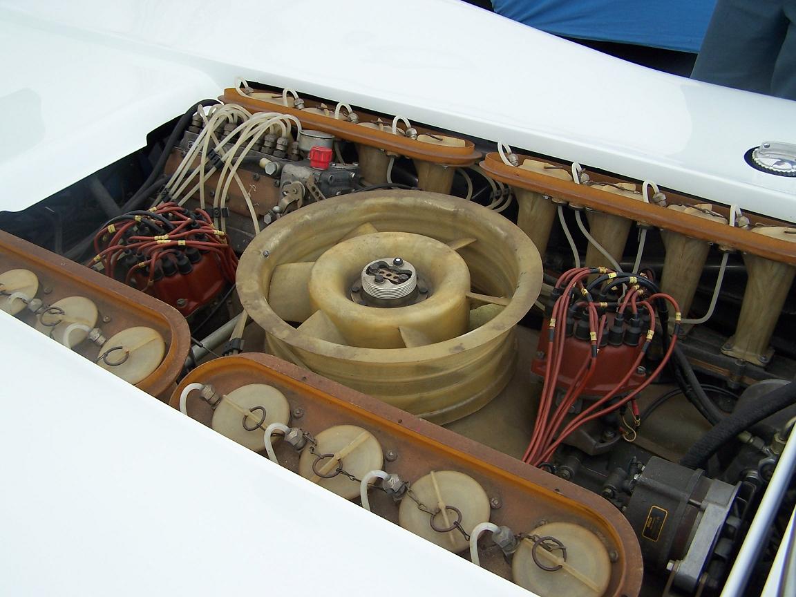

I thought sorting the leads on 6 cylinder was bad enough!
Although the twin distributors on my old Alfa 75 Twinspark was an interesting sight!
Posts: 447
#496 Post by gazza82 »
As was this Porsche engine bay ...

I want to hear that used in anger... C'mon, you can't show us a photo like that and then not tell us all the tasty details...

Zelandeth wrote: Tue Feb 11, 2020 10:58 pm I want to hear that used in anger... C'mon, you can't show us a photo like that and then not tell us all the tasty details...
The Porsche engine bay? I can't actually remember what model .. it was at Goodwood in 2014 and I was just in snap-happy mode .. Ooo Google helps .. Porsche 917 ...
https://www.youtube.com/watch?v=_o8E4WCC4F8
https://www.motor1.com/news/72321/the-m ... ver-raced/
https://www.supercars.net/blog/1971-por ... prototype/
