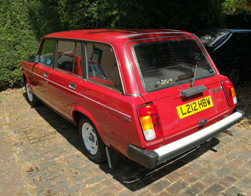

She's a 1993 Riva 1500E - and is a car that I'd been after for longer than I've been driving. If you've seen a deep red Riva Estate in the general vicinity of Milton Keynes, it's probably been me.
Ever since I encountered the Riva 1200L saloon that my grandparents had in the late 80s, I was transfixed even as a five-ish year old. It was the estate that I really looking for though...but could never find one. In fact, it took me a long time to find a Riva at all...First ending up with a Samara 1.3S on an R plate, then a P Plate Niva 1.7i Hussar (very much missed I might add...Fantastic little car), before eventually finding an absolute dog of a 1.5E Saloon, which despite having a hole in the floor I could fit my head through somehow still had an MOT when I got it.
I reckon it's taken me roughly 13 years of active looking to eventually track down this car. Yes...I spent 13 years looking for a Lada. To be honest this only really was able to happen as when my father passed away he left a little bit of money to me. I figured that if I didn't get one of these now it was never going to happen - so after a bit of determined digging and handing over probably a little more than the car was really worth, I finally secured myself my 1500E Estate.
When collected, despite only 12K miles on the clock there were a number of issues.

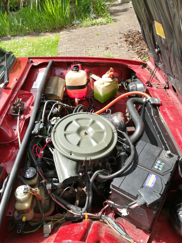

With all the bits now in front of me, I was able to start actually thinking about what was involved. Mostly it was pretty self-explanatory really! Remove part "x" and replace with part "y" for the most part. As it was, I procrastinated over it for quite a while until I ended up having to strip quite a bit of stuff out of the engine bay when my alternator packed in due to a broken brush (replacement sourced from Tom at Lada again for about £2.50 if I remember right!). While I was in there I took the opportunity to replace the remainder of the original hose clips (horrible, evil, nasty, unspeakable things!) on the cooling system as the majority of them were still there - and without exception, every single one of them was leaking. Was also a good opportunity to investigate the non-heating heater.
Once I actually got stuck in, unsurprisingly I did encounter a few things which required a bit of thought - but really no actual headaches.
[] The Riva crankshaft does not have a keyway like the Niva one - so you've got to be careful to make sure that the pulley doesn't rotate on the shaft when you're tightening it up. Likewise it means that you need to manually align it at cylinder 1 TDC rather than just being able to slot the pulley on.
[] The crankshaft position sensor wants to occupy the same physical space as part of the cooling fan shroud - so I had to cut one of the fan support legs off to ensure that the sensor didn't hit it. Still need to bolt on a replacement strengthening bar...
[] Not a problem as I was already aware of it - but worthy of note. The carb setup has the ECU providing a +12V feed to the check engine light on the dash, with it sharing the main ground there. Whereas the ECU on the injection setup expects the lamp to be fed from the dash +Ve supply, and switches the ground connection. So a small amount of wiring modification is necessary there.
[] The EFi Wiring loom is quite a bit thicker than the one for the carb setup - It will still fit through the hole in the bulkhead though - but it's big rubber bung won't. You'll need to either shave the bung down or enlarge the hole.
[] Throttle pedal. The biggest engineering challenge I've had to solve so far. The Riva uses a frankly bizarre system of linkages, pushrods, pivots and ball joints to translate motion from your foot to the carb. Think there were nine changes in direction I counted from one end of the system to the other...Whereas the Niva uses a simple cable. You can't just retain the Riva setup as A: The throttle lever is in a totally different place, and B: Several of the anchor points for the pivots are no longer available as they disappeared with the carb and old inlet manifold. However you can't simply use the Niva's pedal either...Firstly because the two studs it bolts onto in the Niva aren't there (okay, that's relatively trivial to resolve with a couple of bolts and a drill), but mostly because the Niva's footwell is a different shape...so the offside front wheel well is in the way of where the pedal wants to be.
I've currently got a bodge using half the original linkage cable-tied to the new throttle cable which then actuates the throttle itself. The is strictly intended to be temporary and gives quite a notchy throttle response...but it's worked for testing purposes! The final solution will be to modify the Niva pedal I reckon and add the bolts needed to secure it. I haven't decided whether the best solution will be to bend the existing Niva pedal or to cut it off entirely and weld it back on in the new location. Tend to think the latter may make more sense as it's a pretty strong bit of metal.
Fuel pump wise, I decided to just test things out with another injection pump I had laying around from earlier fiddling around with another car. The throttle body has the fuel pressure regulator built in, and the whole system only operates at around 30psi, rather than the rather more terrifying pressures that a lot of systems seem to run at. Connecting my pump up (initially outside just to see what it would do) and measuring the pressure showed that the pressure regulator was quite happier with the (on paper) slightly more powerful pump, the system pressure sitting right smack in the middle of the acceptable range and the pump sounding perfectly happy. This was good, as it meant that I could go ahead without having to wait to track down a good Niva (or Scandinavian Riva) pump - though that's still on my list as it'll be a far more elegant solution. My current setup is a bit of a bodge.
I'd also tested that the ECU would respond to the input from the CPS and would fire to coil pack. A quick note on this...Do NOT EVER run the ignition system on this thing without HT leads and plugs attached. I initially made this mistake - then yelped like a puppy who'd just had his tail shut in the door as a spark jumped from the coil pack a good few inches straight to my left knee with an almighty crack. I do *not* want to do the math to figure out what the open circuit HT voltage shot up to there...but I'm sure it can't be good for the coil packs. Anyhow...Definitely proved I had a *really* good spark...
As far as modifying the vehicle wiring is concerned - the EFi loom has a total of five connections to the vehicle loom. Battery +, ground (attaches to the engine via the distributor blanking plate retaining nut), a switched 12V feed "power on" feed, the check engine light connection, and a 0-5V feed that on the Niva drives the rev counter. Other than that, it is completely self-contained. I had to terminate two or three (can't remember without consulting my notes!) wires in the engine bay that were formerly associated with the ignition system, but the rest of it just pulls out along with the old emission control system wiring loom. So there's very little actually hackery involved, and it would be entirely possible to return this to stock if I so wished.
For testing purposes I borrowed the 12V switched feed from the heated rear window switch relay coil feed - as that gave me a quick and easy thing I could kill the system with in the event of an emergency while testing, that would be easy to find while flailing in panic.
While I had done some tests of the basic hardware off the car beforehand, I wasn't entirely sure what to expect when I first tried it. I didn't know what state the injector was in, I didn't know whether the TPS was any good, I didn't know whether my timing setting was correct, the ECU was a complete unknown and I still didn't know whether the smaller engine was going to be an issue map wise. I was rapidly running out of daylight, and still didn't have the lambda sensor or air intake temperature sensors connected, and had some horribly jury-rigged fuel connections but wanted to see if it would run. I (somewhat gingerly) turned the key, half expecting either nothing or horrendous backfires - but instead the thing almost instantly "whooshed" into life, and immediately settled into the smoothest idle I'd ever heard from the car by a long shot.
YouTube Video of that first test startup over here.
The following day saw me tidy the fuel supply arrangements up a bit so they were slightly less likely to fail spectacularly, figure out a bit of wiring hackery to temporarily connect up the existing lambda sensor (3-wire rather than 4) as I couldn't get the old one out with the tools I had to hand. The spanner I had was too fat to fit between the exhaust and the steering box. However I'd ascertained that it should work just fine with the existing sensor as the ground connection (which is floating on the new 4-wire sensor, but is via the vehicle chassis on the old one) is just tied to vehicle ground at the ECU end.
With everything actually connected up now I was able to let the engine properly run up to temperature and confirm that everything was still good. It was...The only gremlin I'd found so far was that the ECU output for my check engine light appeared to be dead. This still remains the case...so I'm keeping my eyes open for another ECU as I'd really rather like to have that working (aside from the obvious fact that I need it sorted come December for the MOT!). Idle was maybe a little on the high side - though listening to some of the old recordings I have of my Niva, it's actually pretty much exactly the same...so maybe that's just how they behave.
The one thing I hadn't connected at that point was the throttle pedal...as this was the point at which I realised that it wasn't going to be as simple as just adding a couple of new bolts for the pedal. I swore a lot at this point as I'd only a couple of hours before spent quite a bit of time removing the entirety of the Riva throttle linkage - which I am absolutely convinced was installed at the factory well before any of the hydraulics for the clutch or brakes, the inlet nor exhaust manifolds. Extracting the linkage was an exercise in skinned knuckles and moderate frustration leading me to wish that I could temporarily suspend a couple of laws of trigenometry. I pretty quickly realised that putting the original pedal back in and part of the linkage back in place then coming up with a bodge to connect the two (cable ties!) was the only quick solution I was going to find. Putting the linkage back in place was even more frustrating than taking it out.
Still, I got it in there eventually and came up with a working (though highly shonky) joint between the old throttle linkage and the new cable. While the throttle action was a bit notchy it would do just fine for test purposes. At least it would mean that I could take the car for a test drive and see if my work had actually paid off or if it had all been a massive waste of time.
The answer was that it had definitely paid off. The power delivery was far more linear and definitely featured a bootload more torque at the bottom end. It was also for the first time since I got the car possible to travel on a very light throttle opening without the car missing, backfiring and generally carrying on - which it used to take great pleasure in doing when trying to drive at 30mph. Stamping on the throttle resulted in the car simply getting on with business and accelerating rather than the brief "intake of breath" that I'd been utterly unable to eliminate before.
The one thing I really did notice though was that the induction roar was almost comically loud on wide throttle openings - it honestly sounded like someone had stuck a huge Webber and a freeflow air filter on the thing. Unfortunately this also brought with it a horrible resonant boominess anywhere north of about 3000rpm. Refitting the air intake warm air mixer and air intake tube did help tame it a bit and mostly did away with the resonance issues, but it still has quite a noticeable bark to it when you put your foot down.
Around town aside from the far more linear and less "twitchy" power delivery making the car far *easier* to drive - which I reckoned made the work worth it in itself - it was tricky to really tell whether I'd be seeing any real world power gains. My original aim honestly had been to improve the general driveability of the car rather than to add power, but I wasn't going to complain if that came as a by-product. I figured the open road was probably the easiest place to find out on that though, so headed for the A5 to do a quick test. Yep...Definitely got more power on tap! Maintaining 70mph requires about the same amount of throttle now that 40-50 did before, and overtaking is something that can actually be considered less than five miles in advance. Before it always felt that the car could *do* 70mph, but it wasn't really happy about it. Following the injection conversion, it now felt quite happy to do 70, and has "more in the tank" it feels like. Honestly feels like there's enough power there now that it could handle another gear or an overdrive to bring the mechanical noise down a bit when cruising! That would rather be missing the point of the car though, wouldn't it?
I'd be really curious to have a shot of a 1.5E Riva with the electronic carb in actually proper working order (I've never managed to achieve this I reckon with either of mine, nor the example on the Samara 1.3S I had) to compare how they behave.

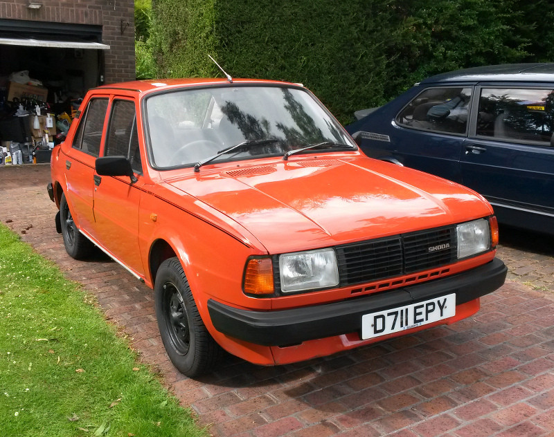

1987 Skoda Estelle II 120LX 21st Anniversary Special Edition.
The special edition was celebrating 21 years of Skoda officially importing to the UK. It got you some graphics on the car, a certificate, a set of crystal wine glasses, and I believe the radio/cassette was thrown in for free.
This is my third rear engined Skoda. The first being an equally violently orange E plate 130GL. That was an immaculate car save for needing a good polish and the vinyl roof re-covering. Well, it was until the driver of a diesel tanker decided to drive in front of me across a main road and I ploughed into the side of his cab at about 50mph anyway. Suffice to say that made rather a mess of the poor thing, and that was the end of E44KHT. Real crying shame as there wasn't a spec of rust anywhere on that car and *unlike* every one I've had since, she ran beautifully. Only problem I had was the usual disintegrating clutch release bearing...but anyone who knows these cars knows that bearing is made of cheese anyway. Changed the clutch roughly two weeks before it got written off...D'oh!
The second one was a 135 Rapid (yep, 135 not 136. It's essentially a 136 but with a lowered compression ratio, single point injection and a cat, originally intended for Canada apparently before they changed the emission regs there) which was a problem child. I had it for two or three years and think it spent about four months of that time actually on the road. I had a plethora of niggling problems with it from day one, but eventually lost patience with it when the gear linkage snapped one evening. It then sat for about six months until the brakes started to play up and it turned out there was more rust than I'd originally realised hiding under some filler. I sold it on (back to the original seller actually I believe!) at that point. No idea whether it ever ended up back on the road. Can safely say that injection system is one I never want to see ever again.
This one was found courtesy of a friend sending me one of his infamous "have you seen this on eBay?" Emails. I hate these, as they almost invariably end up with me buying yet another car. Sure enough, it did. I paid far too much really for it, but it had the advantage of being relatively local rather than at the far end of the country where most Skodas tended to turn up (I was staying in Aberdeen at the time). Sadly this car has previously spent a lot of its life sitting around in a shed somewhere rather than being used...and it hadn't really been properly recommissioned. They'd done the bare minimum to sort the brakes (which work fantastically well I might add, despite apparently still having the original discs and pads) and to get it an MOT. This meant that I have had no end of issues with perished hoses, bushes and myriad electrical gremlins. It also meant that the head gasket had been cooked because the coolant expansion cap wasn't holding pressure which meant it had a really odd intermittent overheating problem that took me a while to track down. I thought I'd got to the bottom of this, but it's still playing up at the moment.
My current plan for this car is to sort the overheating (again), then get it a year's MOT. At that point it will be going up for sale, as frankly I've lost patience with it...Especially now I've got the Lada which ticks many of the same boxes for the fleet, yet is rather more practical. Also easier to get parts for.
The 120LX is a bit of an oddball model. For all intents if you looked at it you'd assume it was a 130. You've got the rev counter on the dash, the four pot calipers and the semi-trailing arm rear suspension...but it's only got the 1.2 litre engine rather than the 1.3. There are quite a few people who have theorised that the model only existed by accident! Afraid I've no interesting anecdotes to add on that count.
