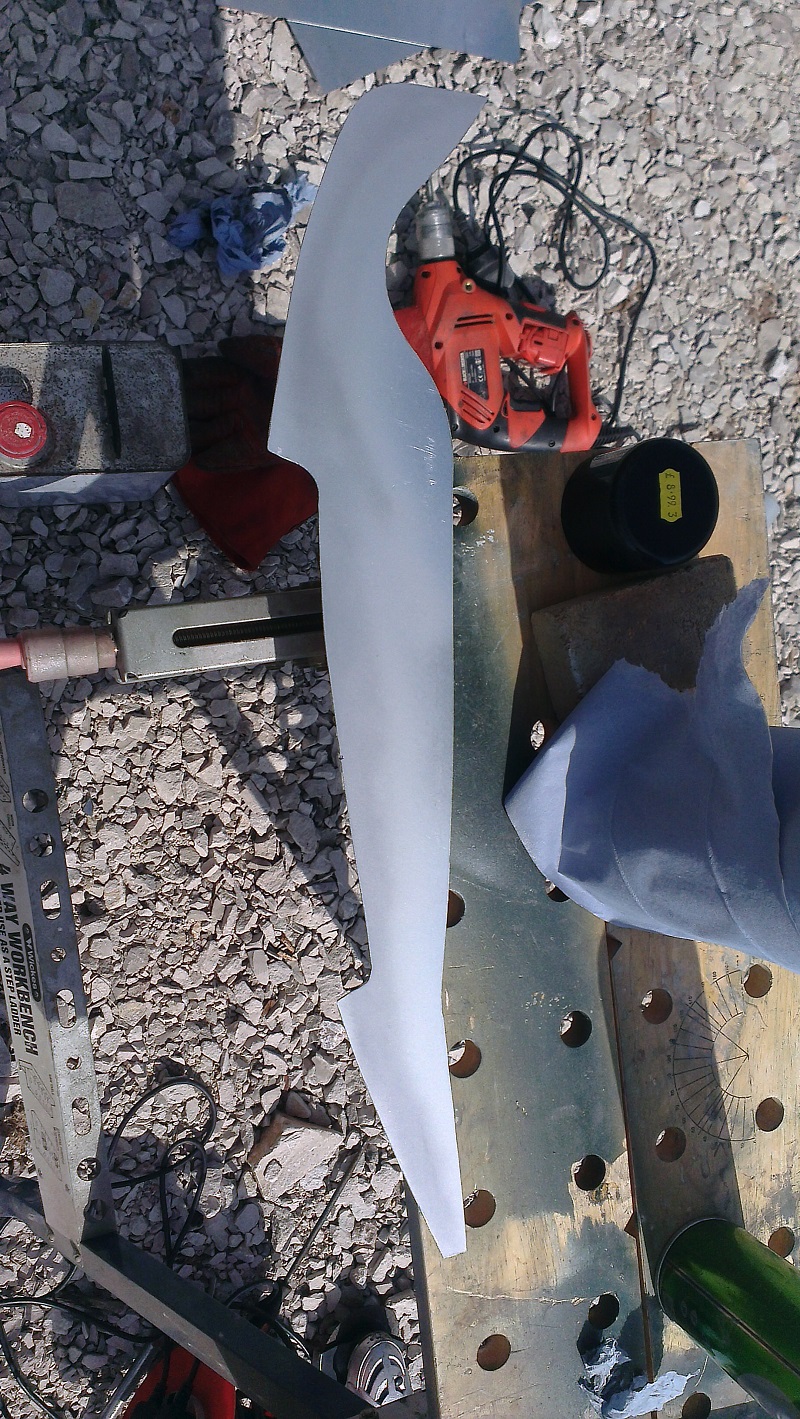

This is the NSR corner/light box
A bit scruffy on the outside
ruined on the inside
So I had to make up a new piece
Drill out the old one, clean up the rust and weld it in
While cleaning it up for painting, I discovered the car has been resprayed once before
I also made up some floor / wheel arch repair sections which are now welded in.
There are other bits welding such as 90% of the wheel arch now being solid again that are done. Pics to follow shortly.

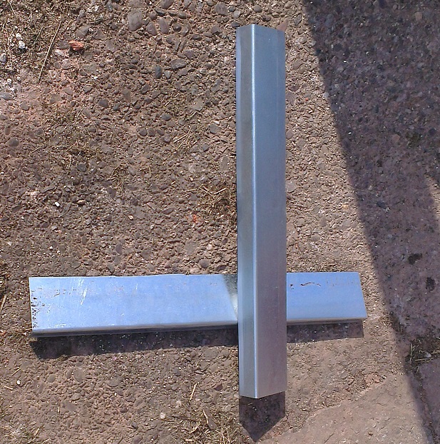

Parts made / collected:
new boot floor and extension to replace the patchwork of metal that was there
lower rear tailgate seal mount
z sections to replace the corroded lip that the boot floor sits on
rear seatbelt bushes and mountings
all new brake flexi-pipes (the rear ones have unions made entirely of rust)
lots of grommets, P clips and cable clips.
Lots of 1.2, 3 and 5mm steel.
