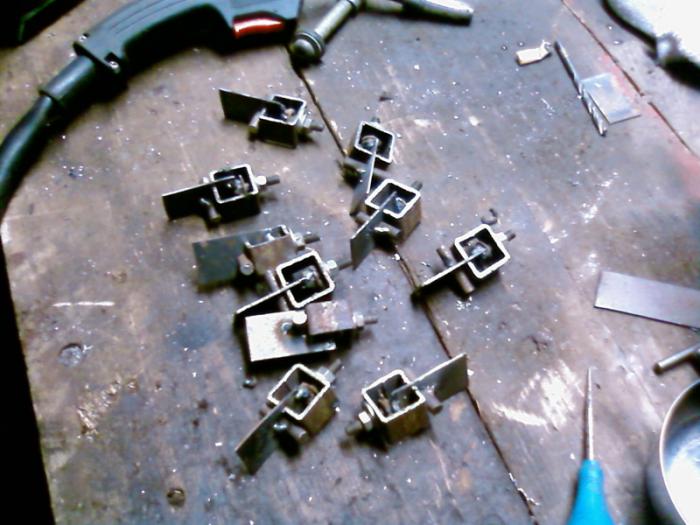

Cut away every little sign of wasting and pitting or you'll end up welding it further inboard in a year or so, join the repair to the original steel with Intergrip-style clamps which give the perfect gap and make sure that it all stays level then, once the welds are all ground flat and some etch primer and paint applied, you'll have a virtually undetectable repair that'll last.
Make sure that the steel you use to make the patch(es) is of the same gauge as the original, don't compromise on safety by using something thicker, or on ease of welding by using something thinner. :)
Intergrips picture borrowed from http://www.mig-welding.co.uk thanks to Guido for permission to post it here.
