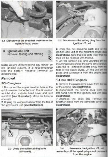

Posts: 447
Re: 206
#8 Post by gazza82 »
Plugs will be below the coil pack. Take off the engine cover and there should be a long "block" with an electric connection at the end (right as you look). That's the coil pack. Probably has three fitting screws. Pulls up and off and plugs beneath that. They are probably deep in the head too.
My Haynes manual isn't too clear and I've not seen a 1.4 SOHC engine but this is how most engines are now.
Don't use NGK plugs if you have a Sagem coil pack. They don't like each other. I fitted Bosch to our 206CC 2.0 and they were fine. There seem to be three main makes of coil packs.
Distributor? Not a chance! Crank and cam sensors talk to ecu which decides firing cycle.
Tried to get a few pics from my haynes but they came out too large. Plugs are Bosch FR7DE or equiv and gapped to 0.9mm.
I can recommend signing up to 206info.co.uk as the forum there contains a lot of useful info. It's a bit quiet now but it's a good library! peugeotforums.com is fine as well but takes a lot more searching to find what you want.

#10 Post by gazza82 »
Dick,
Hoping this may help
Plugs are torqued to 25Nm or 18 lbf ft
