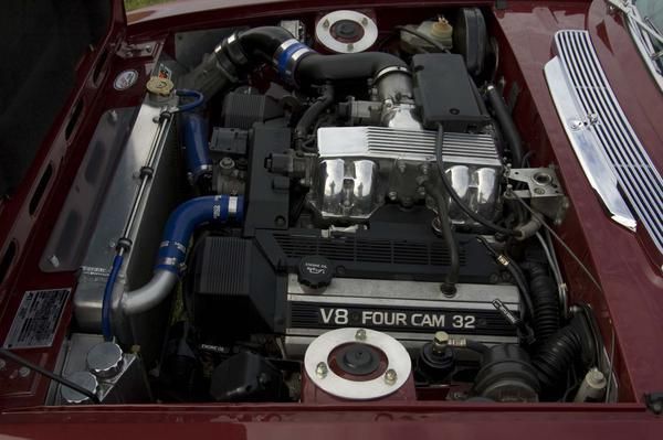

However, if you want to do the job neatly and just can't stand the idea of using a relatively crude, pushrod V8 that doesn't weigh enough, Toyota to the rescue with this conversion from the Untied States:
I'm thinking that the diff, driveshaft joints and rear tyres may be the bottleneck in that one though. :lol:

i cant get your linky thing to work john :?
Re: Electric water pumps.
#10 Post by JPB »
Fixed that now, Rich. (I NEVER use my Bhotophucket account, ever, but that's where the piccies of this car are stored for some reason. Bhotophucket is rubbish, and images hosted there never work straight away as flickR ones do..) :oops:
