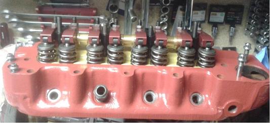

The finished head .. which is Red, not pink .. see the pic of the block for the actual colour. This is a 12G1805 Cooper Mk 3 head with new double springs, A+ valve seals, and paint job. 1.5:1 roller rockers, but I also have a set of original forged Cooper ones ... I've blocked off the bypass and they are stainless steel nut/studs/bolts for the thermostat cover and heater valve.
The funny bit in plug 3 is my tried and trusted spark-plug thread cleaner. The bottom off a Champion with slot cut up the sides.

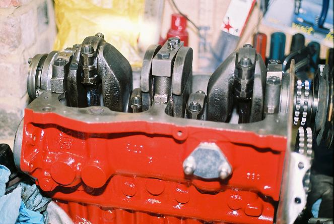

For the bottom end, a +60 thou overbored 1275 (now 1330cc) with Minispares Mega pistons. It's got a Kent MD266 cam and Mayle/ACL bearing shells. The engine was used in a rally MG Midget in the '80s and was in perfect condition. The crank has standard sized journals and just has the centre strap. New everything where needed with upgraded head studs and nuts. I picked up a vernier cam gear set so that is next on the list to be timed in.
It's getting a spin-on oil filter (from a Mini) and some "bling" .. stainless braided hoses, etc.
It will run with a single HIF44 and use a converted Mini LCB manifold ..
