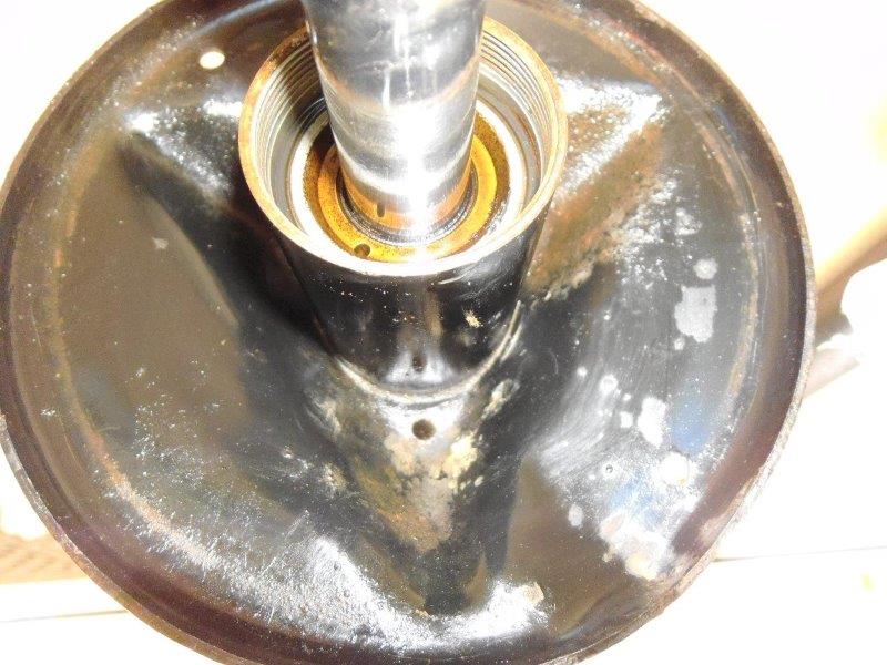

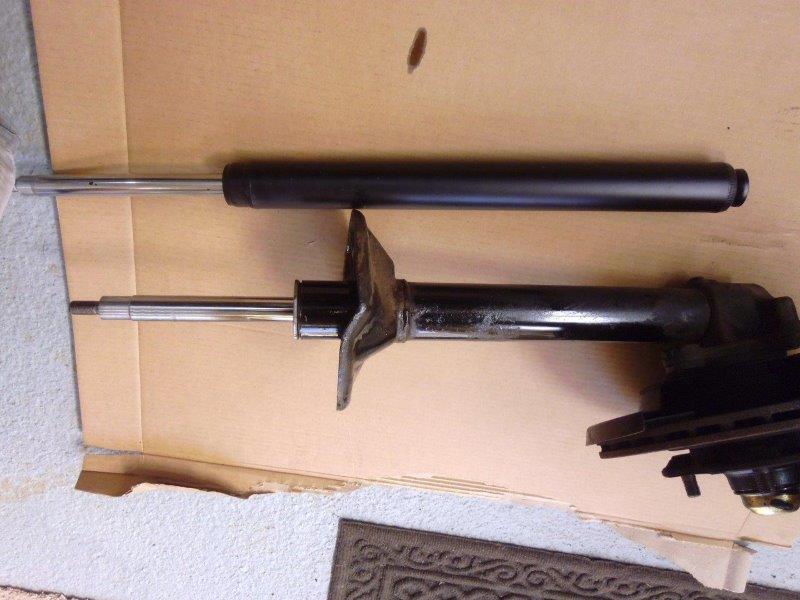

I needed /wanted to rejuvenate the front suspension of my 1983 W910 Bluebird (ie 910 estate). However the KYB listed inserts (parts 665014 or 365011) are end of life and no longer obtainable.
Assured that the struts on saloons, coupes and estates were same size (and I seemed to corroborate that with cross reference charts to other manufacturers) I have bought 2 910 saloon inserts - KYB ref 364003. They look the part however when put against the strut they are about 8 cm too long. Picture attached.
The struts (at least the 1st side I have removed) appear not to have cartridge inserts too and so just may be rebuild-able as an alternative? Picture attached of this too.
Help? What should I do?
Ed

Further research suggests that the inserts quoted by KYB for my car (ie those correctly for the estate and not the saloon /coupe ones I have) are cross referenced to others by Sachs, Monroe, Boge etc but then so are the (too long) ones I that have also cross referenced to those same units. So I am reluctant to buy more inserts without seeing and measuring! I have confirmed briefly with KYB that the units they list for my car are no longer supplied.
So in order to get the car back onto its wheels and back onto the road (I do want it out for marshalling WRGB in Hafren next week .....) I will clean it all up, put the new strut /tie bar bushes on that I have, swap a track rod end and refill the struts with fresh oil pending finding better inserts for another day.

Some Shock dampers are rebuildable even if the maker didnt intend that someone would try to.
Dampers are simple machines that flow oil though small holes.
I have seen schader air con R12 valves brazed to dampers.

One strut had a lot less fluid to drain out than other and damper action felt jerky before refill. Both struts thankfully were clean and shiny inside and leak free. I have refilled each strut with SAE10 fork oil, and action is now much smoother. Fingers crossed that it is all better than before when I get it back down on the ground.

Thanks as ever John - I haven't been able to access Nissan4u.com for a while, and still cant so I will try another browser (just hangs trying to load, no http or time out error etc).
I believe that the struts on my car do not have inserts at all, just pistons, rods, valves or whatever within the outer case. When the gland cap was unscrewed, and the strut tipped, oil came out, and was pumped out by action of the piston rod. So I refilled little by little with fresh oil, working the piston up & down to draw in the oil (and I hope the air out). There are threads around describing wet struts (that dont accept inserts?) also on 260Z's and on 120Y's. Fingers crossed.
