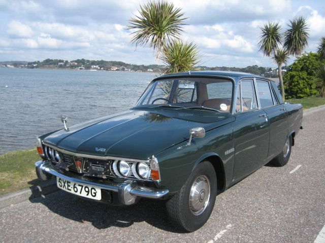

It had to happen not long after buying the white S1V8! :roll:
How could I say no to this Arden green gem!!!
An early 1968 S1V8,43k miles and a 2 owner.
Chassis no; 42501465A
Engine no; 42501497A
1st reg'd 1/8/68,not sure of the build date yet?
The 1st owner had it held back to get the new G reg!?
1st owner from 1968-74 did 20k miles!
Last from 1974 till 2014 did 23k miles and it was dry stored from 1995 till 2014.
Just 43k miles genuine,never ever been welded!! :D
A super solid base unit,a near mint interior,really sweet and strong engine and box!
Dry stored since 1995.
Recommissioned and new MOT.
Initial inspection done by Stina,"Cheers mate :) "
I went to see it today,did a full poke about checkover,in,out,up and under!
Test driven,the price negotiated and the deal done!
Collection next week,hopefully along with a nice cache of spares,from the previous owner!
Just haggling a price for all of the NOS spares!!
Only obvious faults,it needs 4 wings and a total repaint,as most other panels have very minor scabs/scars,but no dents!!
And part of the cache of spares includes 4 NOS wings!
And a set of 4 still boxed side/ind light units!:)
More next week once its home and I can have a play! :D
Hopefully in about 2hrs,the white one will be sold!

Its now home and performed well on its 1st long drive back from Poole to Bristol, for 20 odd years!
Sweet as engine and box,handles nice and tight,no slop in the steering or suspension!
The interior is near mint,only needing a hoover and light clean up!
Have now got it up on the ramp,and took the cover sills off,and apart from a bit of original underseal peeling and a light surface dust rust,and the dumdum seal between sill and floorpan old and crumbly,there is no rust anywhere on the underside! :D
Never have I seen a car so solid as the day it left the factory 46yrs ago!
The wings are shot,and there are scabs all over the body panels, bumpers and lights chrome shot,but as I also got a NOS set of wings,NOS set of lights,and I have a nos set of bumpers,a full body refurb is all it really needs,and wont take long,once ive saved up some more pennies!
Piccys :D
