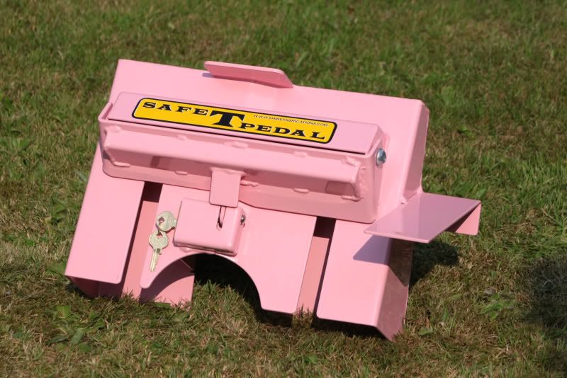

I've seen these pedal locks which look simple enough to make with just an abloy pad lock but there rather heavy and clumsy looking and I don't really want it kicking around the van and I doubt I'd be bothered ever using it.

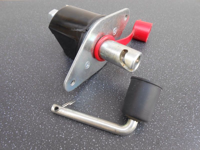

That's similar to what I'll be putting in, I'm lucky that where I work we use a lot of stuff like this 8-)
Battery isolator like this will be going in the engine bay off the main battery, I'm lucky with the camper as it's going to have a second leisure battery similar to a caravan which the radio etc will run off anyway. So no need to put links in for radio memory.
