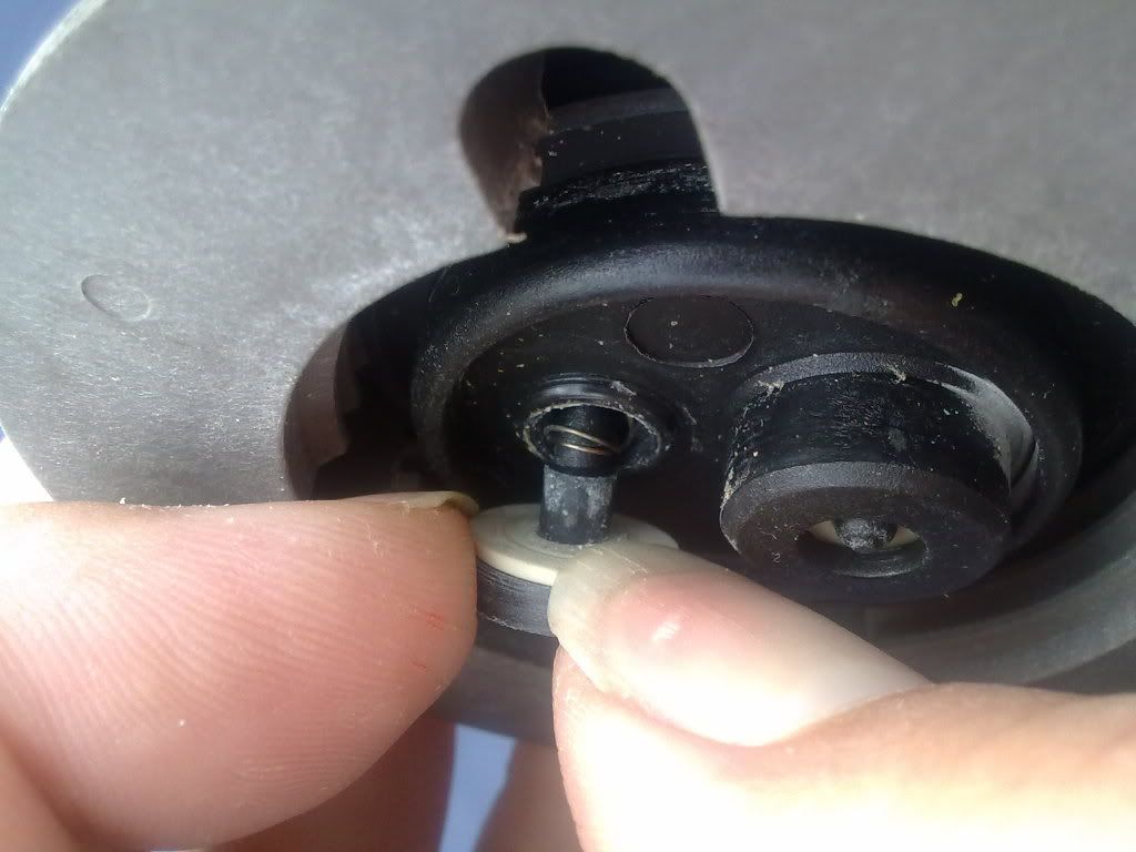

#10 Post by Mitsuru »
John and Luxobargewe are all wrong, it's not solid cap and it's not
a rubber that deforms under pressure. I took this cap off a v70
from scrapyard with the idea of dismantling it and cutting it/cutting
it up.
Luckily the cover over this which goes into the tank just came off
easily.
So it is a tiny spring loaded valve on one side for air in, an another
valve for air pressure. And according to a couple of websites and
ebay sellers it is to 22psi (1.5 bar).
