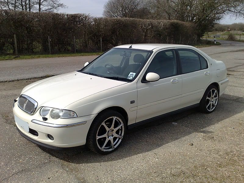

Any Rover or MG with the L series diesel will do the job just fine, around 50mpg, the 45 saloon TD is refined when you're sat in it, ball all the L series variants are noisy from outside, just beware the post 2001 ones as bits started to get removed so soundproofing isn't as good as things like underbonnet sound pads stopped being fitted. I had a cracking 45 TD saloon, air con, heated seats, great mile muncher, it's life was cut short by a numpty in a Mondeo clouting the front.
Can pic up decent ones for £5-600 and you should make most of that back after. Plus no head gasket issues with the L, only real problem they have are the usual diesel problem of EGR valves, (just pull the vac pipe off and plug it up) and the MAF meters dying cutting power and limiting revs to 4000, easily sorted with a replacement or a MAFAM kit from RoverRon.
This set me back just £540!
