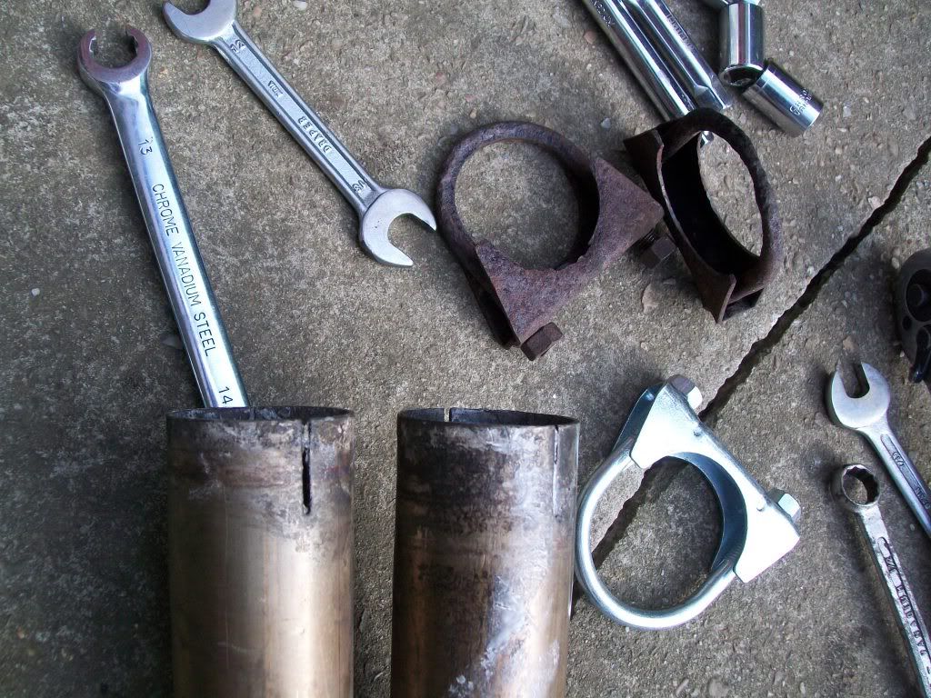

Wit MOT gtime coming up and my already loud system getting louder I thought I'd better have a look, so it was up on the ramps and sure enough it was blowing from where the manifold meets the pipe....but although the pipes look as good as new despite being on the car for twenty years (someone paid 430 notes for the system and sports manifold
...the bill came with the car), the mild steel clamps had corroded virtually to nothing allowing the joints to move, just look at the state of them!It just goes to show, stainless isn't just fit'n'forget

Cor! They look like they've been underwater for the last 20 years

If you wanted to get something to rust faster, a good way would be to heat it up and spray water on it - ideally with salt in it. This is exactly the conditions these things live in, especially in winter, so no wonder really.
Stainless exhaust on my Volvo and Jag, but the clamps quickly get in an appalling state, any work you do on the exhaust you're never going to get them apart, always have to cut off and replace, which I have done on the Volvo.
I do wish they'd make stainless clamps too!

I don't like the "U-bolt clamp" as they kink the pipes and can make them hard to get apart again. Older Fergy and Massey Ferguson tractors used a flat "strip" clamp which was much better. Mind you, I hardly ever tightened them up as it made it much easier to take the exhaust off to get into low buildings. I doubt that's a problem with a car though!

Good call, however the exhaust joint on Volvos (and Saabs) of this era are a ball-and-socket type, with a ridged clamp that goes around the outside, so these wouldn't work. I don't like the design as it's not very strong but you're stuck with it really.tractorman wrote:A quick search came up with these:
