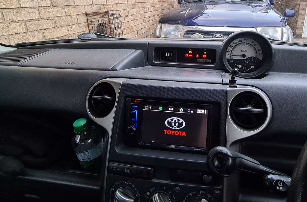

Regarding a DAB aerial, I put a Kenwood DAB set (seen below these words) in my daily driver to replace the Clarion that came fitted, but was running Windoze CE and sadly couldn't be updated with an English language version, meaning that it insisted on telling me that I was in the sea, just off the bottom of Japan.
I found the screen mounted DAB aerial that came with the set to be utterly hopeless, but by building a very simple attenuator/ splitter in a finger case, both analogue and DAB come in with superb sensitivity using the car's original pillar aerial, which is in fact far better everywhere than the factory infotainer which came as standard in the CH-R hybrid demo car that I borrow when the daily is in for service.
The source of supply for the attenuator splitter is the set's (blue) electric aerial motor feed, but the mint green one that's grounded to the cage as the usual way - connecting to the reverse lamp switch that lives inside the steering column - was interfering with the rear camera view, itself essential as turning my neck to see right the way out of the back window isn't physically possible and besides, only gives a rough idea of how much further back I need to go to touch the bumper of the 164. Leaving a gap means that the bB would then be slightly over my pavement. That's what happens when I have a car holidaying on my drive as well as sixteen feet of Hilux estate and the daily.
It's an easy circuit to build, though depending upon the amount of room available it may be easier to buy a ready built one from eBay or wherever.
