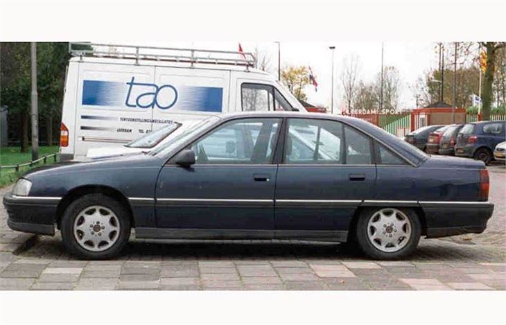

What got me thinking of doing something along the fender skirt idea
originally popped into my noggin, was at a car show and there was
an immaculate Vauxhall Carlton.
http://www.bbc.co.uk/bristol/content/fe ... swider.jpg
But realising that just a straight line across wouldn't look quite right I
