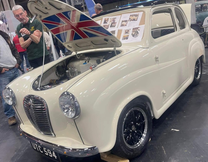

Based on the HDRC Academy cars with a 1310cc Marina engine.
Powered by a 1310cc HDRC-spec Marina Engine

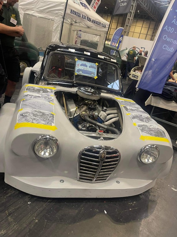

This one is a space-frame with an A30 body suitably modified to fit over the top and is designed as an out-and-out race car. Yes that is a small block V8. :shock:
Yup .. a V8
Yup .. a V8
