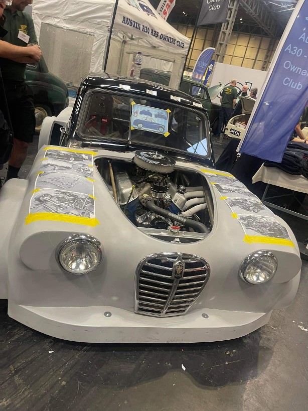

The A30/A35 Owners' Club stand was a popular point though .. possibly due to these ...
Based on the HDRC Academy cars with a 1310cc Marina engine.
This one is a space-frame with an A30 body suitably modified to fit over the top and is designed as an out-and-out race car. Yes that is a small block V8.
