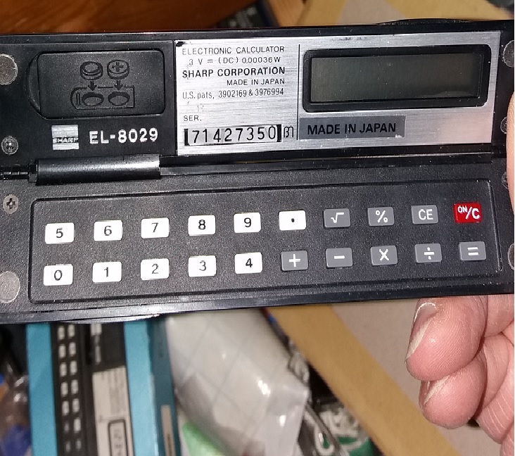

Seeing your old calculators reminded me I had this one tucked away. So when putting the Christmas Tree back in the loft I pulled it out of it's hiding place.
It's not working.. my guess is the ribbon cable has broken. I did plan to try get it repaired as Sharp had a service outlet not far from where I grew up .. but it closed before I could arrange anything.
It's designed to go in a pocket like a pen (it's about two pens wide). It also came with a case .. described as leather but clearly artificial.
Looking it up on 'tweb it seems it wasn't a big hit as it was introduced in 1977 and discontinued the same year!!

gazza82 wrote: Thu Jan 07, 2021 5:16 pm Seeing your old calculators reminded me I had this one tucked away. So when putting the Christmas Tree back in the loft I pulled it out of it's hiding place.
Sharp were big on the "How small can we make a calculator?" game in the late 70s. I give you the EL-8130A.
Which looks pretty normal until you realise that it's barely 5mm thick.
This is also from 1977.
Shame that one doesn't work. As you say it's likely the ribbon cable that's to blame, especially if it's one of those carbon composite ones. It may be repairable, though it's hard to say until you've got it apart in front of you (though it's worth a Google search as someone may already have done and documented it).
