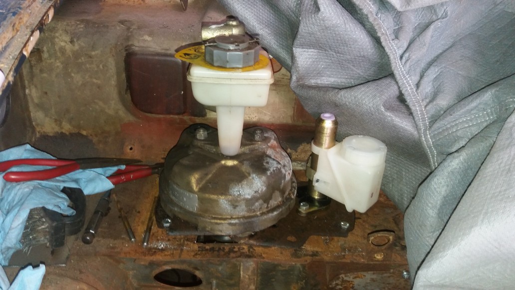

So still working on the brakes and clutch pedal .. have now incorporated a 3mm mild-steel plate beneath the trimmed down Metro plate as advised by a couple of Owners' Club members who have made the same modification. The battery tray isn't that stiff apparently and even less when you've chopped a small section out with two of the stiffening indents.
You can see the Metro plate here and I'm now mounting the servo the other way around with the two outlets on the right so pipes all run bewteen the two masters for neatness. I've also got hold of two rear brake restrictors that are fitted to the Metro that hopefully will stop the rear brakes locking up prematurely.

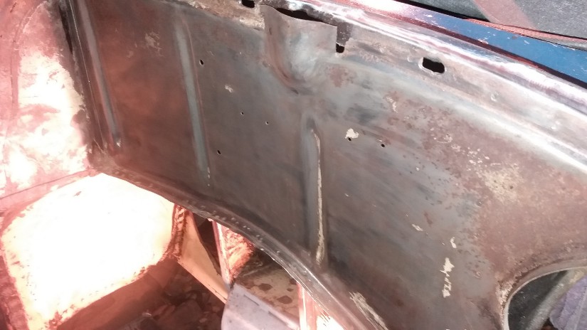

And get the back gunk called underseal off ... which involved scrapers and white-spirit .. and elbow grease ..
That inner wing/wheel arch had a fairly large dent in the side .. you can probably just make out the creases. A large hammer and block and plenty of noise and it was almost flat again.

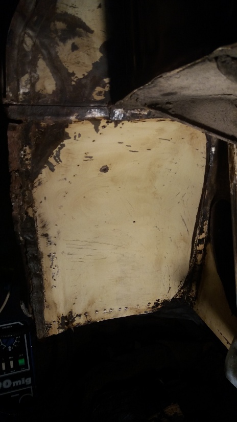

I'll add an update in the next couple of days .. just need to sort out the pictures but since my last update several areas of metal have been cut out and replaced and I've destroyed a number of flap discs and wire brushes! :D

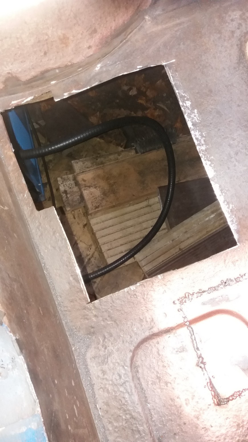

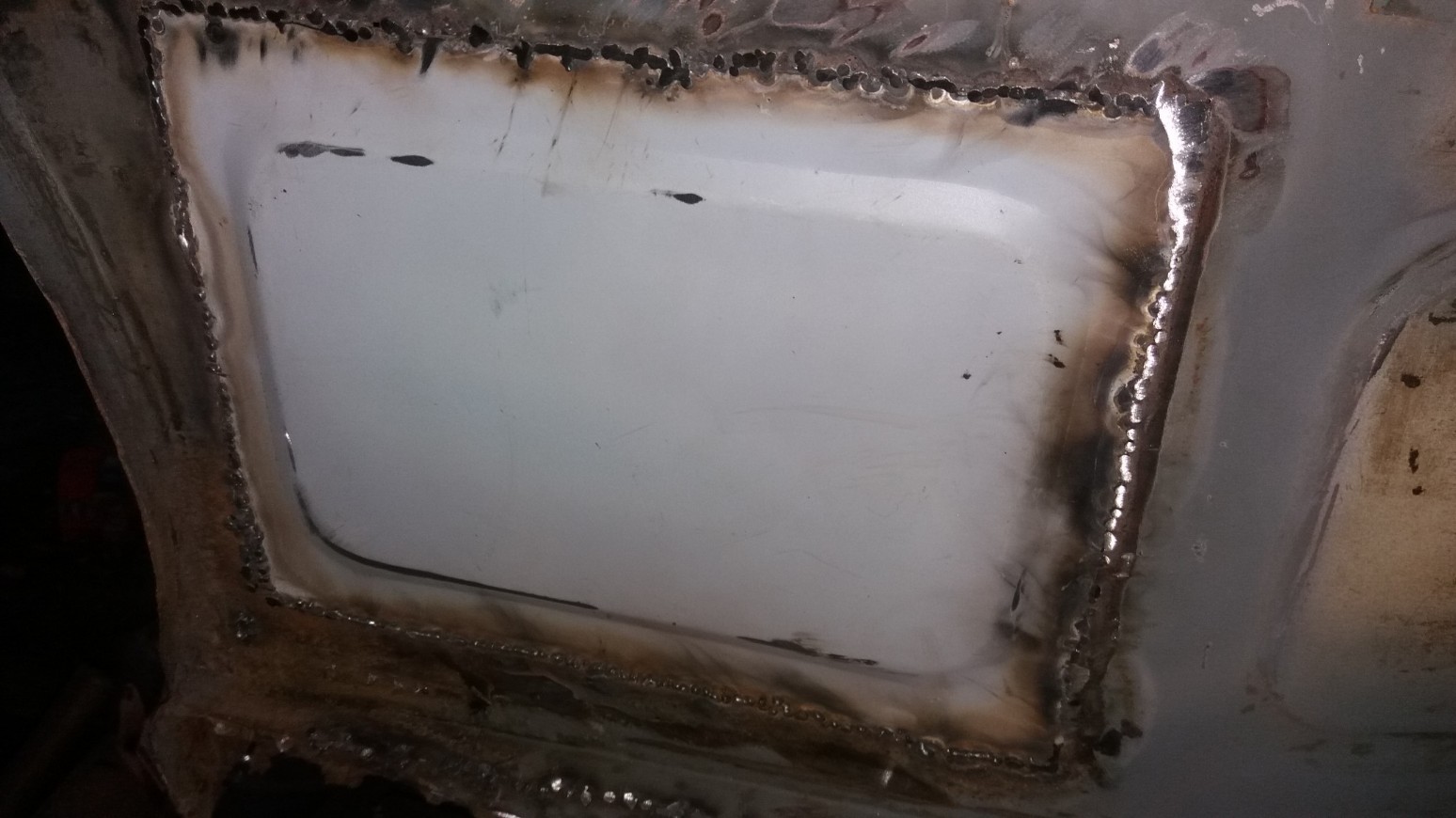

Went at floor with angle grinder .. there was a large "L" shaped rust hole where they fitted a steel box under the floorpan to transport the shell ion the production line. This is a known detritus trap and slowly rusts away
Then added in some new metal
Had to do this on both sides but rather than chop out the whole floor section I just cut out the depressions and a small edge and welded it in. On the passenger side the rust had also started a bit further back too leaving lots of pin holes, so that has also been sorted. You can probably see the new patch in the first picture .. it's actually a corner from the driver's side floor that was in better condition and had already been cut out and replaced with new metal. Waste not, want not!

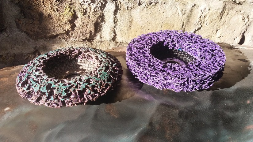

Have now started to grind off several layers of primer and paint from front panel and front wings but it is not kind to the discs .. :roll:
(or probably the environment :? .. 'Elf & Safety means I wear a good multi-filter mask and snug fitting goggles to keep ME safe! ;) )
May need more than the five purple coloured discs for my 100mm diam grinder I've already bought as I still have to do from B-posts back and boot lid. Luckily bonnet is replacement and primered.
