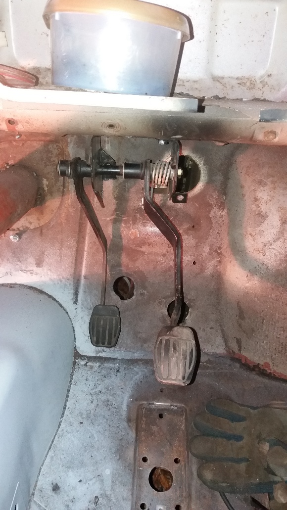

Anyone who has had an A35 knows the brake pedal operates a master cylinder under the driver's floor pan. This makes it liable to seize as it always gets very wet and also hard to top up as you are under the steering column and dash .. :shock: In the picture below you can see the location of the master cylinder in the floor to the left of the glove fingers.
So I'm moving the master cylinder(s) to under bonnet in a more conventional position courtesy of a Metro pedal box as this also has provision for a horizontally mounted servo and the master cylinder above that. (There is plenty of space under the bonnet!)
This is simply held in the rough position and I've not cut out all the battery tray yet to fit the cylinders, etc.
Those two holes lowdown in the bulkhead are where the original clutch and brake pedals would go. I'm converting to hydraulic clutch too with the Midget gearbox although the Metro pedal I currently have is a cable-type.
I will have to rework my throttle pedal too but that is hopefully a simpl'ish task (again that isn't standard as I'd already converted to a cable throttle back in the 70s).
