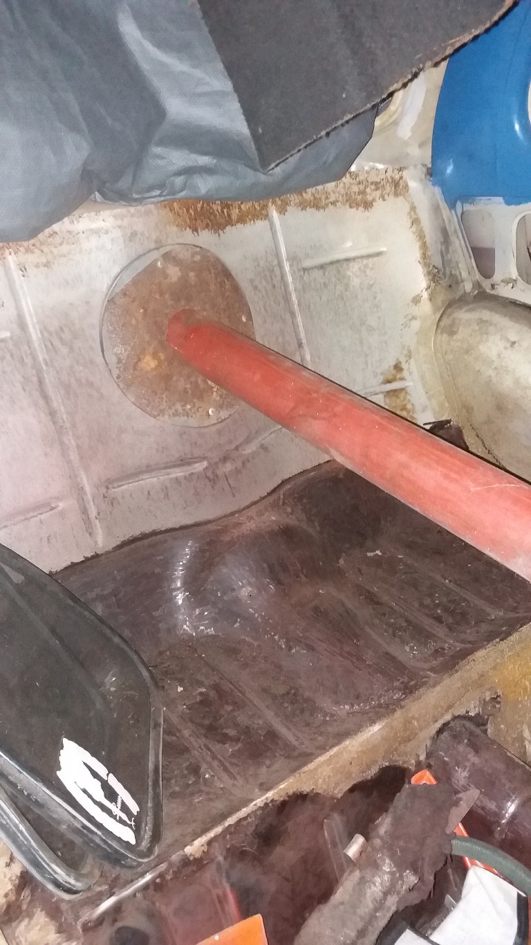

And now devoid of any panels .. fixed or removable. Last one to come off was the boot lid which you can only remove if you take out the headlining and rear seat (the very narrow parcel shelf is actually part of the seat back and screwed in place .. it's plywood!)
It now has this through the centre of the car ...
That is for the roll-over frame once I lift the bodyshell up to reach the clamps (scaffold-clamps on a builders scaffold frame). The rear needs lifting a few inches but the front will have to come up over a foot! I'm told by the owner the shell will then be perfectly balanced and easy to rotate. It isn't too bad to actually lift the front by hand considering the weight of that pipe and the scaffold pipe that runs through the centre of that!
Next up is to remove the bits and pieces floating around the inside and boot, and the bonnet and rear seat cushions I carefully stored on top of the roof! Then secure a plate to the factory jig hole in the engine bay and we should be about ready to try it out.

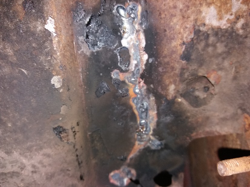

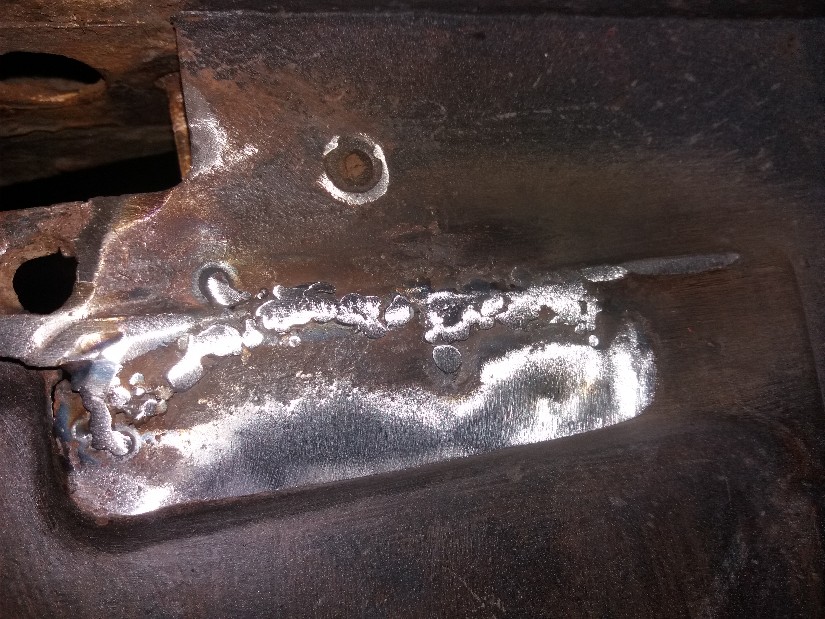

Took a drive up to my local steel stockists and picked up some 20x20 square tube and a Hobbyweld 5 cylinder. I've bought a regulator conversion kit just before Christmas so after a bit of a faff with the original feed hose connector (which should have pulled off but wouldn't!), I connected it all up and had a play!! The new batteries also arrived for the mask so I didn't need to resort to the cheapo hand-held thing that came with the MIG.
No the results were not great but I'm still trying to find the best power and gas settings and may need to tweak the wire-feed a bit. I also need to clean the original metal more as I think this may have contributed to a lot of the splatter, etc. The wire feed did sound a bit erratic, but I think that is a feature of a single-transformer MIG that needs to drive the reel and the arc. It has been sat in the garage for a couple of years so it may just need using and maybe a small amount of lubrication on the reel drive but it was very clean inside and the 0.6mm wire feels clean with no corrosion, etc. It moves ok when it's not arcing! (I'll get the off-cuts out an practice again!)
But I did get some weld on a floor crack without (a) setting fire to the car and (b) setting fire to me! :shock: But I'm relatively pleased with my first efforts and will now try out a few ideas people have given me to try and improve :thumbs:
After some tidying up with the flap-wheel!
