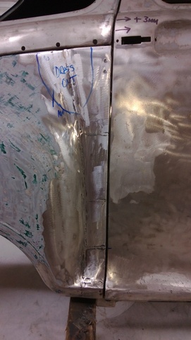

#241 Post by Grumpy Northener »
Offside rear wing was next on the list apart from the leading edge the wing is solid but this area takes all the spray & crud directly off the rear wheel so they always rot out at this point - previous repair covered by body solder
Solder burnt off - you can just see a previous repair with quite neat gas welding that has let in new metal to the leading edge but they have failed to protect the area on the underside of the wing so its just rotted back through again

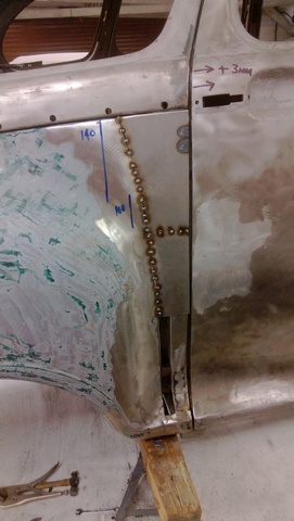

Re: Early Javelin Restoration
#245 Post by Grumpy Northener »
Welded up and initial clean back
Despite a lot of care, taking my time with a hit & miss welding technique and leaving the panel to cool in between welding durations - some heat distortion was still experienced - this would have been far worse had the panel not been firmly held in position
