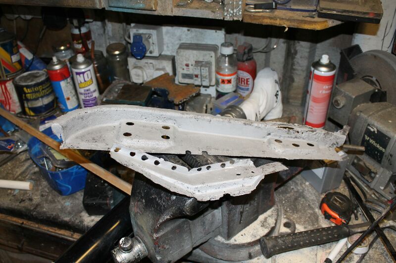

Got my blasting cabinet working today then used it to blast up a couple of the panels I had removed from the minor.
Beforehand both were heavily rusted, the pillar, as well as the area at the bottom which needs replacing, has a few pin holes which I will weld up but both look recoverable and then after a coat of paint they can go back on which will allow the door to be fitted and the rear wing finished.

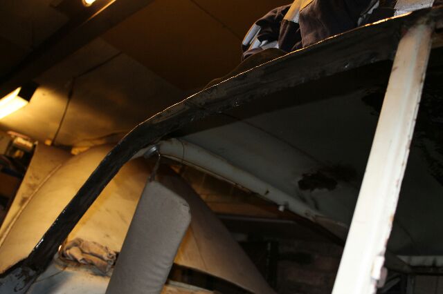

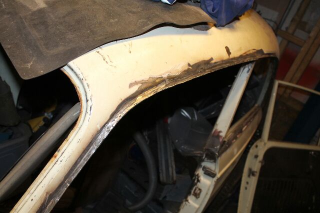

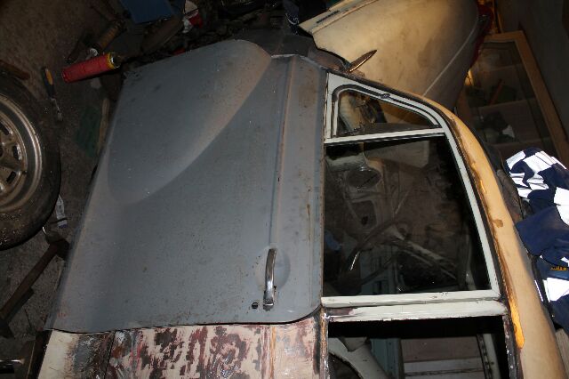

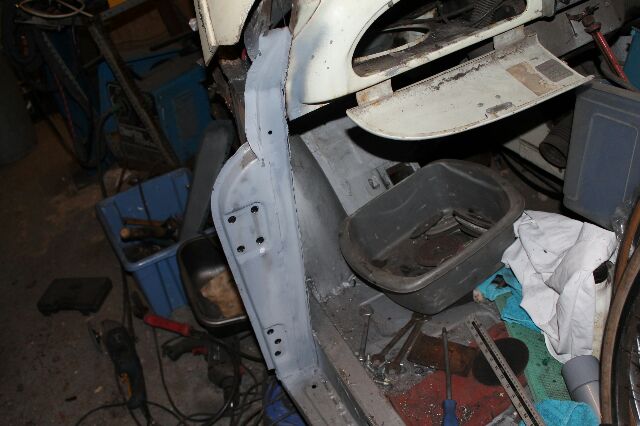

Been busy on the minor for the last week or so door pillar fitted:
Return panel under roof replaced all the way around the door:
Repairs made to some holes and seal flange around door.
Tried the door on but it needs some shims under the hinges ( I deliberately welded pillar on slightly forward ) once this is done I can move onto replacing the bottom of the rear wing and fitting the gutters.

I have spent ages trying to get the door to fit, ultimately I have concluded the door and it's apperture are slightly different shapes, basically if I get the front high enough to give an even gap at the rear the top front of the door hits the A pillar, it may bedthat was how it was built as I have seen others which look similar. Now I have it set up so the front is a good fit to the A pillar, the top of the rear is the right height, the seals fit, and it shuts well but the gap up the back tapers, so the plan is now to cut the rear wing vertcally push it rearwards and re weld to give a perfectly even gap, the lower part of the wing can then be re-fitted.

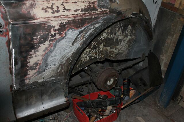

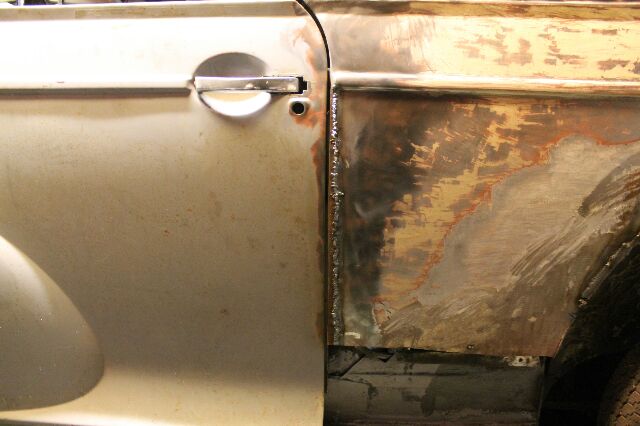

Cut the minor rear wing and welded back up to sort out the gaps.
Then I moved onto the lower part of the bodyside, a new panel was fabricated and butt welded in place.
Next up is to make the closing panels and sort the fit to the rear wing out.

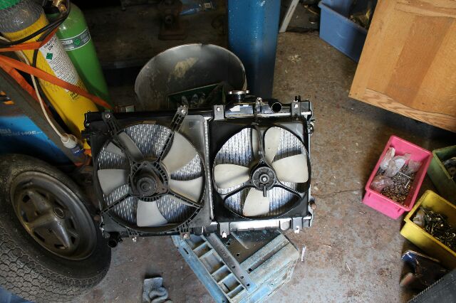

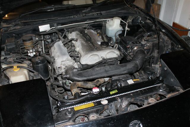

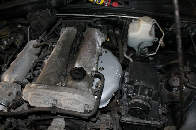

Spent saturday afternoon on the mx5, fitted a new radiator as the plastic header tank had cracked, while it was out the fan shroud was painted (surface rust) as were a couple of brackets for the ac pipes.
The exhaust heatsheild was removed and painted with silver VHT paint and the oil changed. I also checked the diff oil level but could not get the filler plug out of the trans, I will have to make a tool which grips it better (14 mm male square head), otherwise everthing looks fine, I plan to tidy the engine compartment up a bit more and sort out the poorly fitted wing over the summer but nothing to urgent.

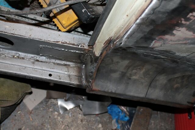

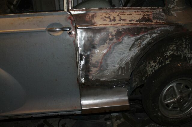

Almost finished the rear quarter on the minor now, just need to clean the welds up, add a weldnut for the wing and a flange for the trim inside then it is on to the gutters.

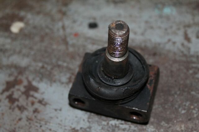

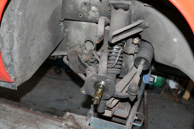

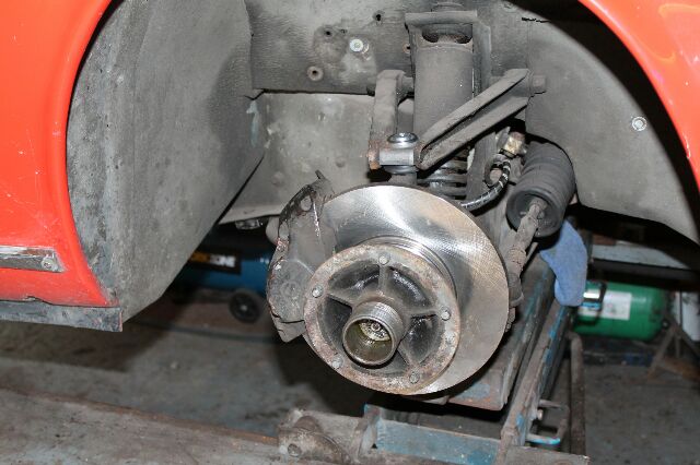

I did manage to replace the front discs and ball joints on the lotus, the ball joints were only a year old and already the gaiters had split and one had some play, the discs were causing judder, a quick test drive and all seems well.

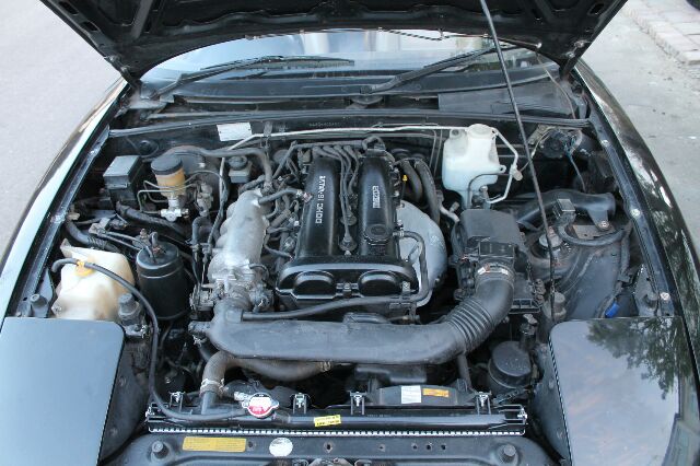

A picture of the painted mx 5 cam cover,

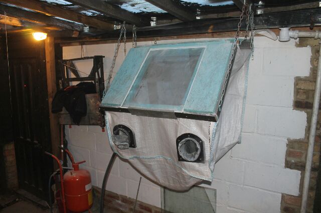

Finally I thought I would share another project I have been working on, a fold flat blast cabinet made from scrap wood and a aggregate bag.
It folds to around 4 inches thick so can be hung on any wall/ceiling, the glass screen leaks dust around the edges and will have to be mounted in a stiffer frame but otherwise it seems to work really well.
