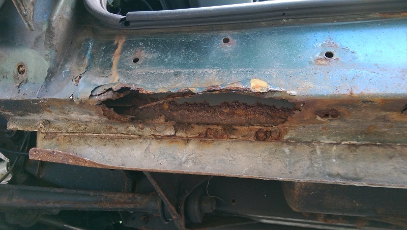

I was having a prod around last week clearing drain holes and discovered the base of the n/s b pillar was made of crud rather than metal.
B Pillar.jpg (162.15 KiB) Viewed 4707 times
Pic after I attacked it with a punch and a hammer. Annoying but not a big deal. I made up a repair ready to cut out the crud and weld on this weekend.

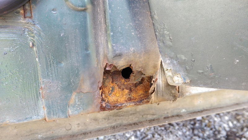

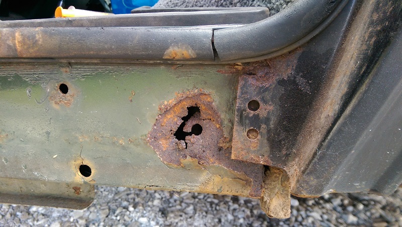

It took longer than I expected to remove my sill trim as every screw holding the lower edge in place was made of rust so I had to cut them all off. I plan on replacing them with captive nuts and bolts anyway so future work will be a bit easier and it should help prevent more rust taking hold.
I was expecting to find some issues behind plastic trim as I think it's the law that all cars are made of air anywhere the MOT man hasn't been able to check for 20 years.
Unfortunately "some issues" translate to an extreme lack of metal.
Some poking and the area under the rear door apart from the very back 4" is solid. From the B pillar forwards it's just rust and air.
After some fun with my grinder this is what came off.
There is much more in need of cutting out but after measuring the metal (1.89mm?!?!) I don't have anything in stock to replace it with so I have stopped and ordered 2 square meters of 2mm steel (as I'm assuming the drivers side is just as bad) to replace it.

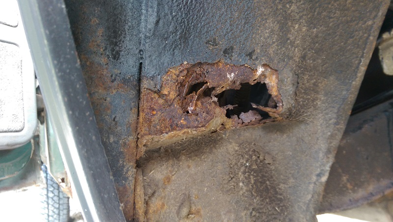

I don't get as much time as I would like to work on this which isn't helped by family commitments but I thought I was almost finished fixing rust holes. Just the drivers side b pillar bottom which I had made the bit for, a postcard size bit on the drivers side bulkhead and the L section that supports the wiring loom under the car were all that remained on the rust fixing to do list.
I got to the car this morning to find the passenger foot well full of water.
Poking about and about 2" further up the bulkhead from where I had repaired the floor, what looked like metal was rust held together with structural paint. Another day of poking and I have cut out about an a4 piece of paper in size worth of "metal".
