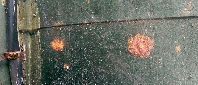

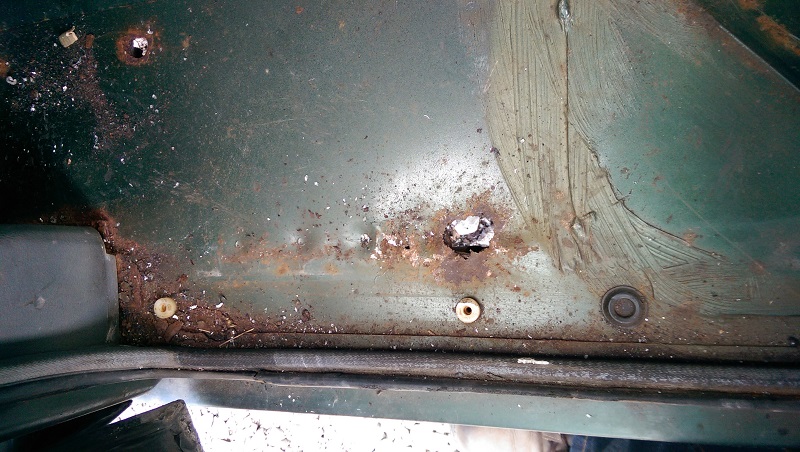

I think your Rangy has been communicating with my Landy - there is now a hole in the offside footwell! Yep, I noticed a bit of scabby stuff and it is now a hole!

Only one hole in your floor pan?
The holes may or may not be related to the scabs. my phone is too full of pictures of rust holes to be sure. However:

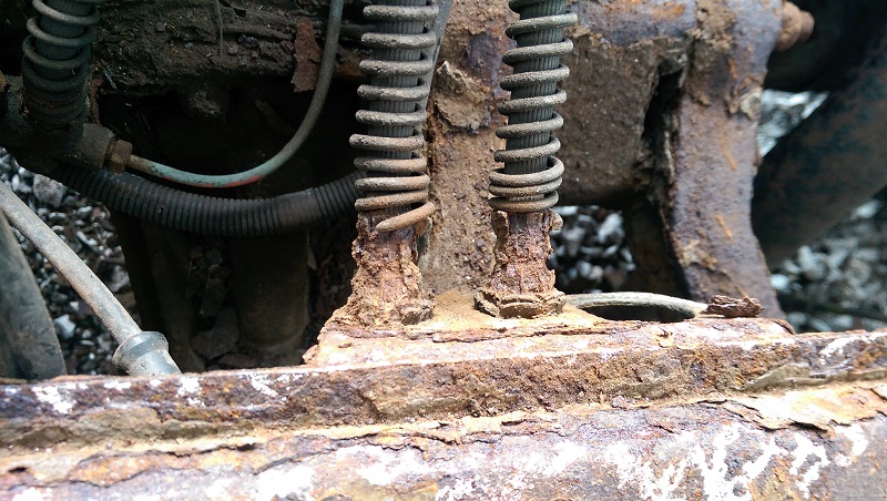

But by far and away the most dangerous thing (if you ignore the potential for one of the rear axle mountings snapping off) was the condition of the rear brake lines (yet to be replaced but as the car isn't mobile I'm not worried right now)
New lines are in my box of bits ready to fit.

A lot of underseal was. If it wasn't for having the floor pan out, it would have gone unnoticed until one failed.
I love old cars and have a lot of patience but I really wish this one would stop fighting for a minute and let me finish one job before finding me another one.
The rusty metal to which the brake lines are connected is also being replaced. it is one of the rear floor braces and is made of rust and air.
