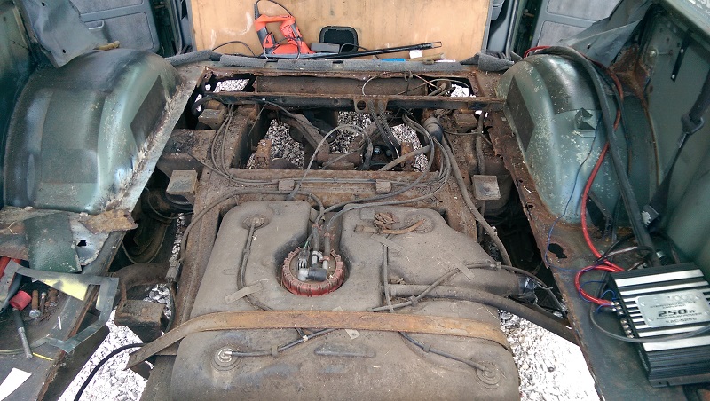

Progress with pictures. After earlier deciding I would try just to repair the rust damage leaving the floor in place, there was so much grot the more I trimmed the more I found so I got annoyed and just ripped the whole thing out.
boot floor out.jpg (194.89 KiB) Viewed 4073 times
Just as well I did as underneath some chassis issues were revealed (both sides are the same so I will only post images of one)

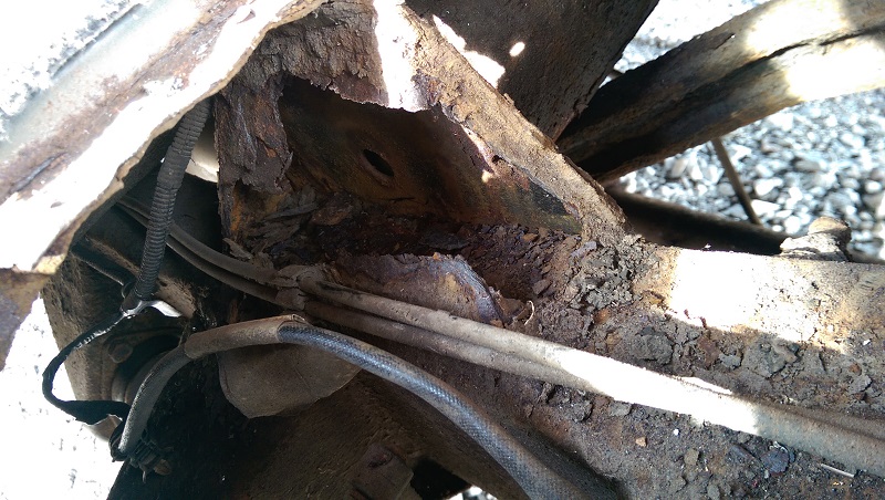

chassis rot.jpg (183.14 KiB) Viewed 4073 times
To get at this I had to take part of the rear floor out. Just as well I did as this is rotten too (not pictured)
but it allowed me good access to attack and re-create a rather important bit normally hidden.

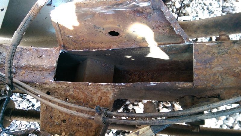

chassis cut out.jpg (185.8 KiB) Viewed 4073 times

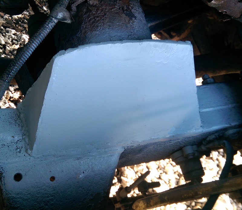

chassis patch 1.jpg (142.07 KiB) Viewed 4073 times
chassis patch 2.jpg (181.45 KiB) Viewed 4073 times
Not the tidiest job in the world but given the silly angles I have had to work at, I don't think it's too bad. it passed the "whack it with a hammer and see if it falls off" test ;)
I haven't got as far as completely repairing the drivers side but the top of the chassis itself is now solid.
I have also started wire brushing and k-rusting the original chassis as you can see in the pictures it is a bit flaky but bashing it with a hammer shows it to be solid.
