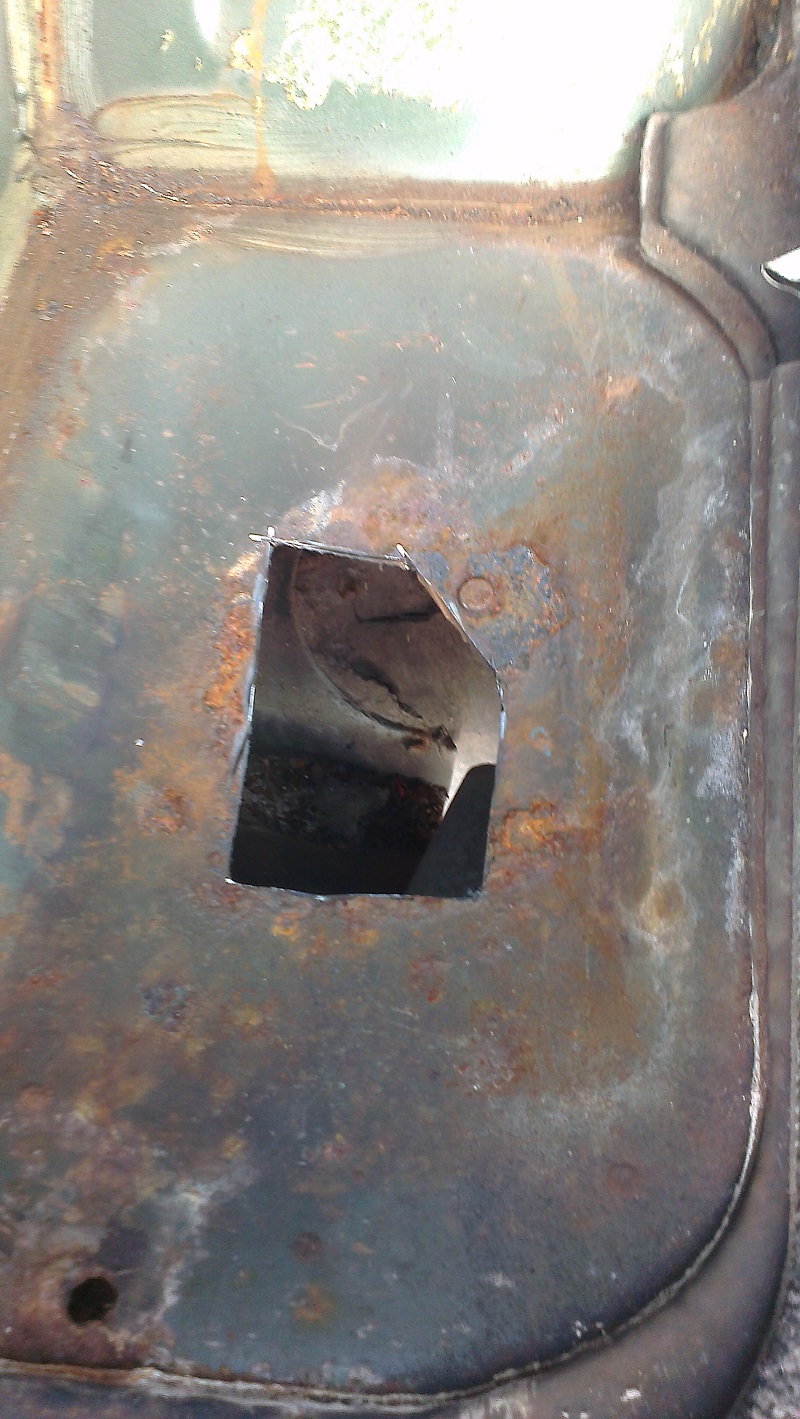

As a big package from woollies arrives on Friday, I started the day working out how to remove the vinyl trim from my D pillars.
Unfortunately as my car is made by Land Rover, it had some rusty surprises for me.
To remove the side vents, you have to take the inner trim of the D pillars so the spare wheel had to come out.
spare wheel well.jpg (322.78 KiB) Viewed 4001 times
Not the end of the world and can be repaired fairly easily.

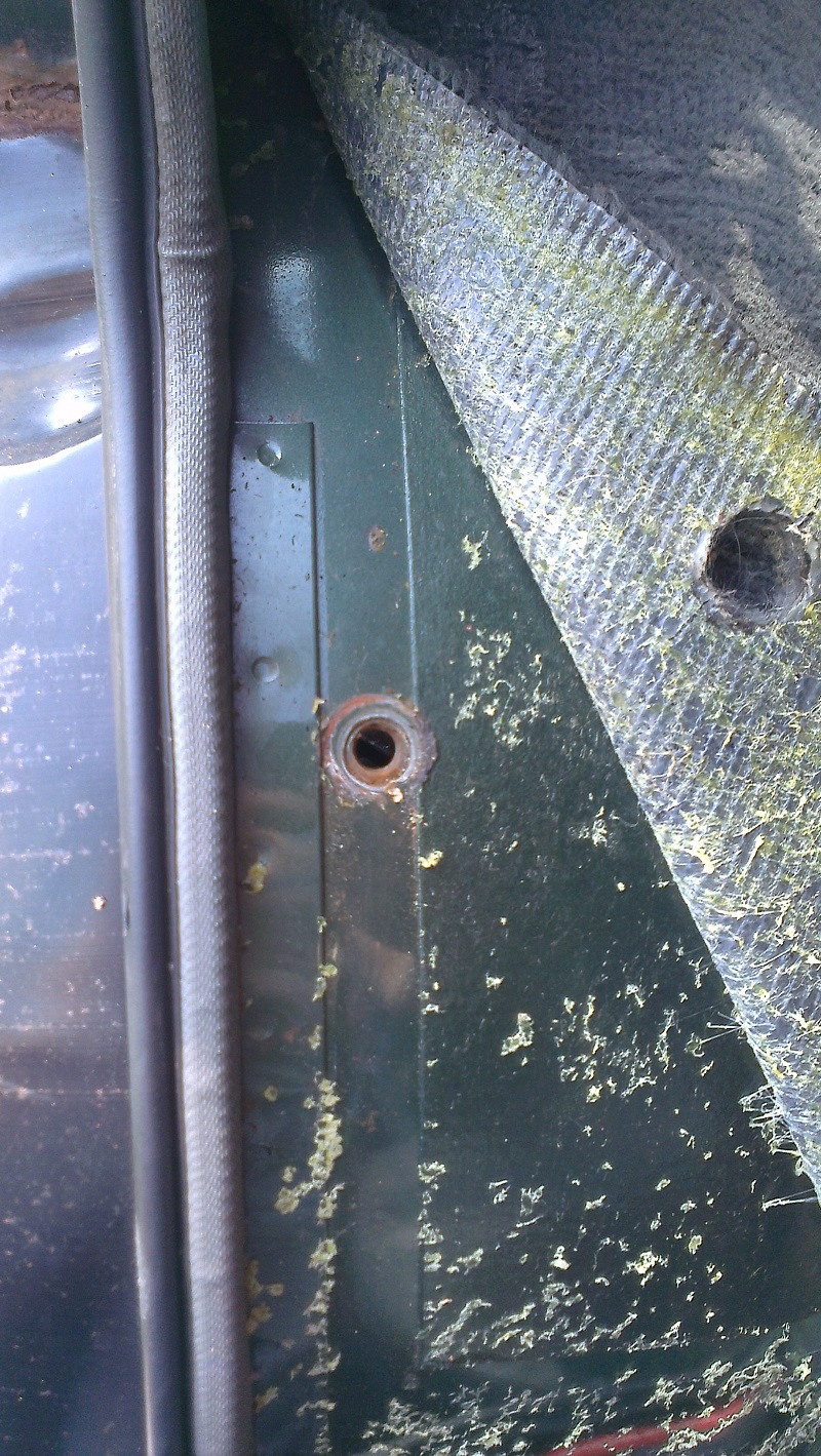

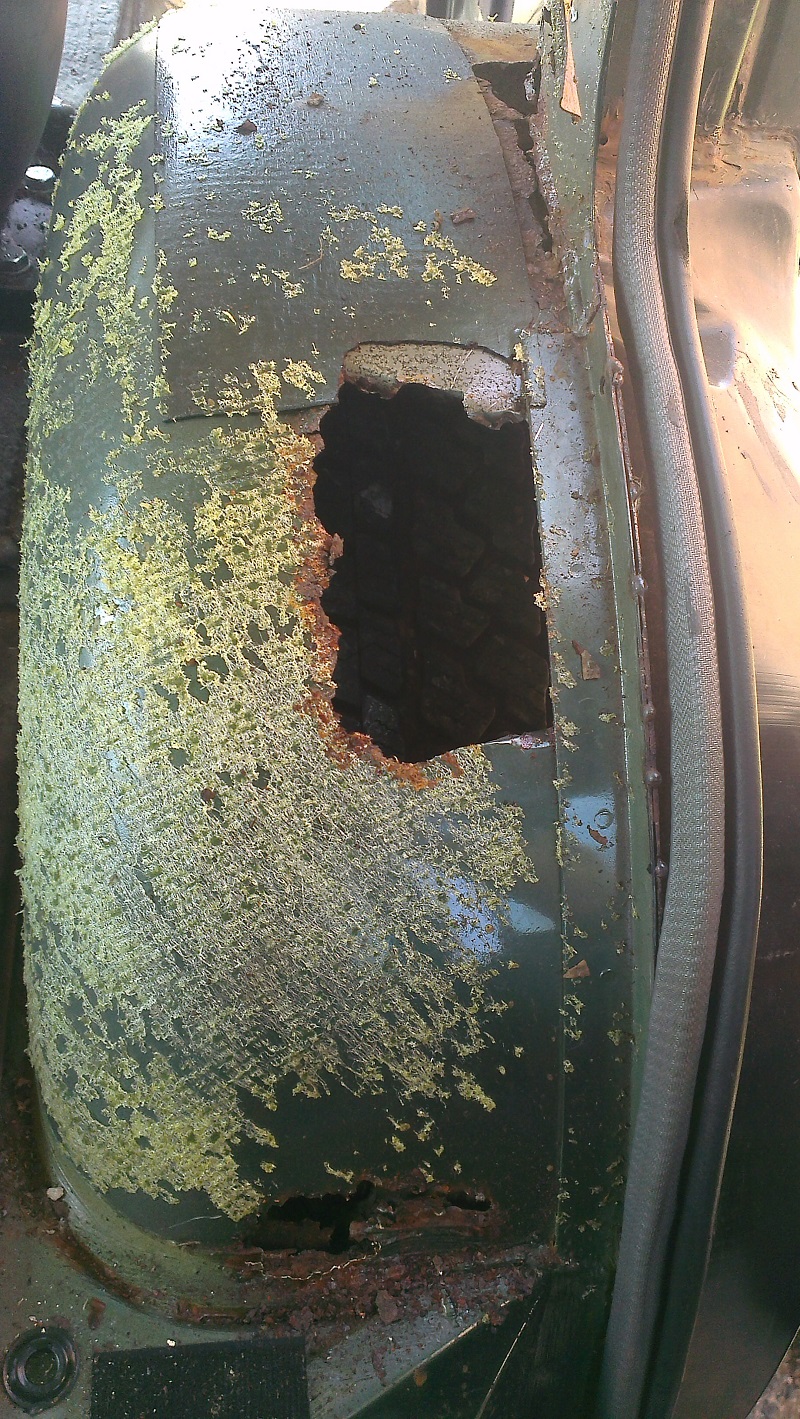

Seeing some rust marks on the wheel arch seams I pulled the carpet off the wheel well to see.
Unfortunately these vents are not factory
wheel arch.jpg (172.64 KiB) Viewed 4001 times
I am also REALLY glad I haven't had an accident with anyone sitting in the back as this is the seat belt mounting point (or lack of it) after I pushed on some rust blisters with a screwdriver
seat belt.jpg (616.02 KiB) Viewed 4001 times
The only blessing is these panels are really cheap at £25 per side. It looks like next weekend won't be spent renovating leather but adding new steel instead. At least the weather is nice and I can do a large percentage of these repairs from inside the car rather than on my back under it! It also gives me the opportunity to re-attach the other wheel arch panel which I have just noticed is tack welded along the top edge rather than spot / plug welded as it should be.

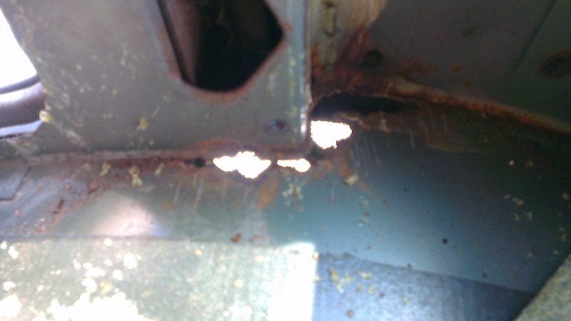

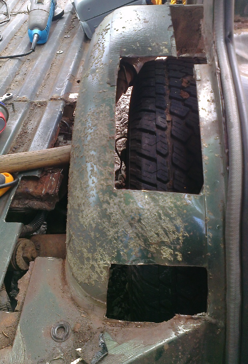

Well, I attacked the spare wheel well with a grinder to remove all the thin / holed metal
spare wheel well cut out.jpg (350.36 KiB) Viewed 3990 times
then filled the new spare wheel cooling duct with metal as I realised that spare wheels don't get all that hot
spare wheel well fixed.jpg (464.19 KiB) Viewed 3990 times
As the passenger side was quite so bad, I thought it would be a good idea to check the drivers side. Fortunately the seat belt mounting is fine
drivers side seat belt mounting.jpg (522.89 KiB) Viewed 3990 times
However there is no shortage of extra ventilation
drivers side wheel arch.jpg (84.71 KiB) Viewed 3990 times
My amp / sub is on that side so some extra air flow might have done it some good (or not as the case may be)

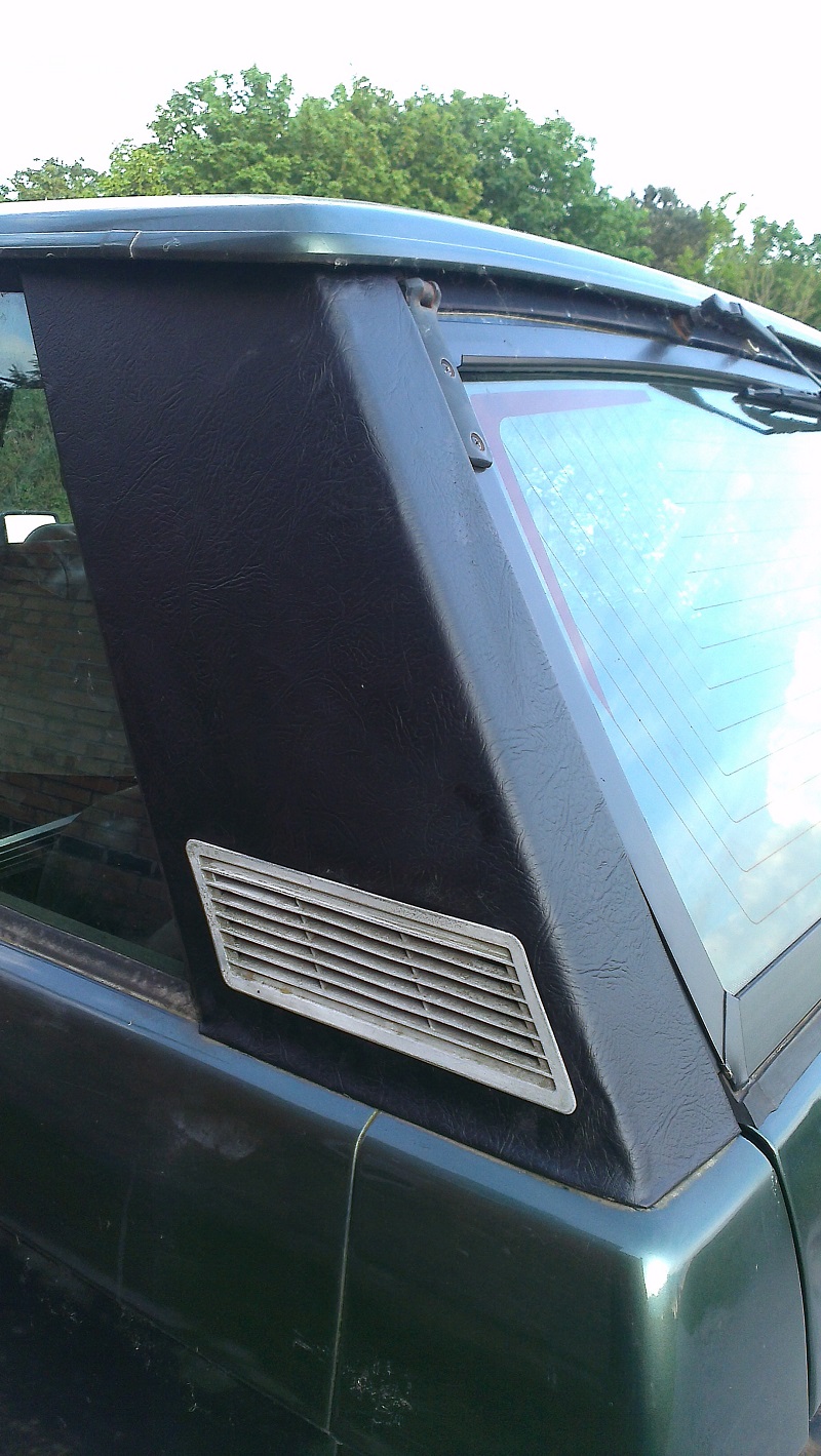

Now, finally on to the job I had actually planned on doing today.
I removed the vinyl trim from the passenger side D pillar (I was going to do both but metal work took priority today) as it has a split in it
split vinyl.jpg (228.12 KiB) Viewed 3990 times
replacing it was surprisingly easy although not the neatest job in the world, I am quite pleased with my first attempt

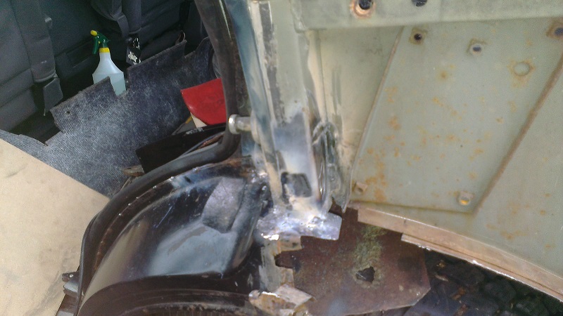

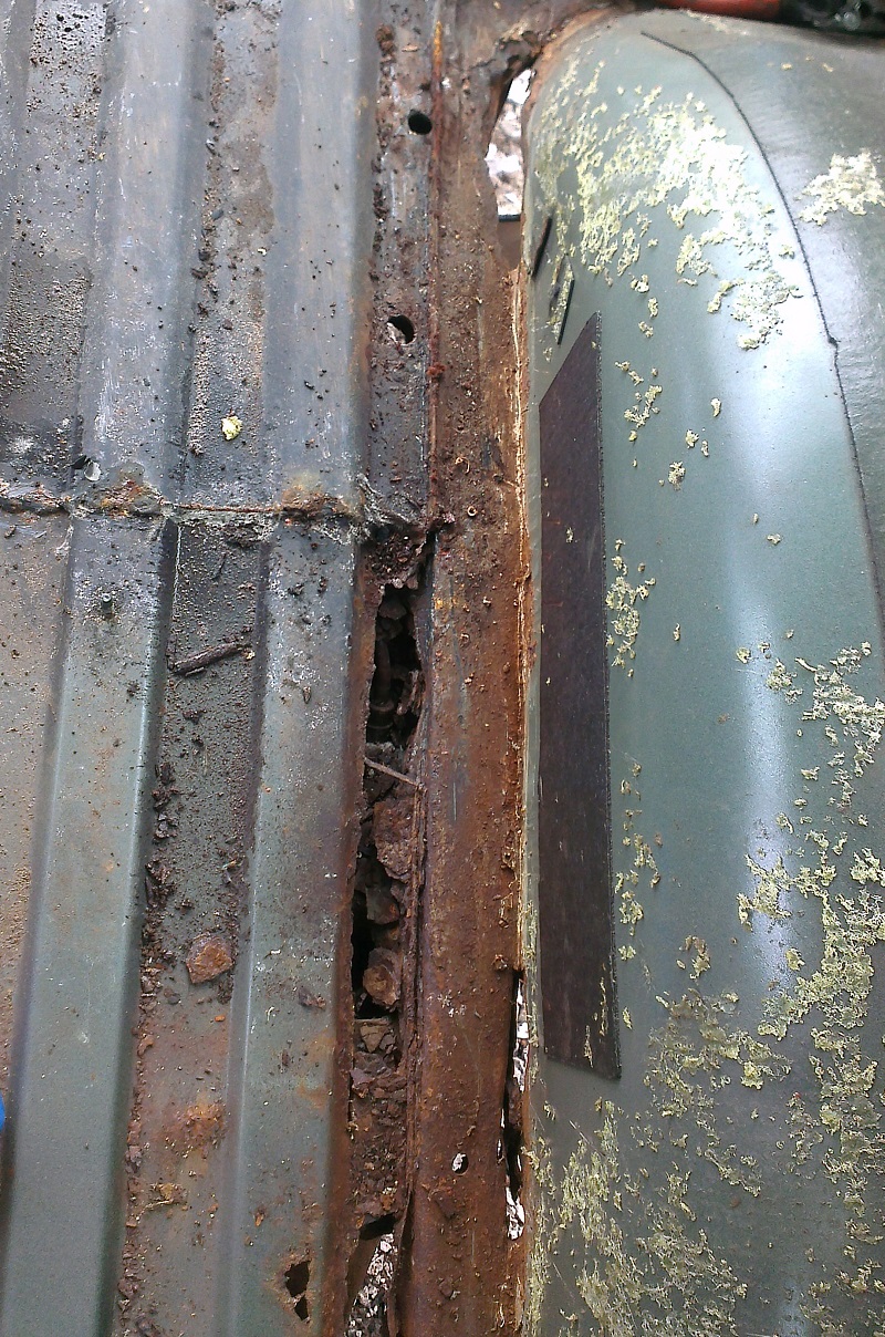

My last update was a few weeks ago so despite the weather preventing me doing huge amounts of work, some has been done.

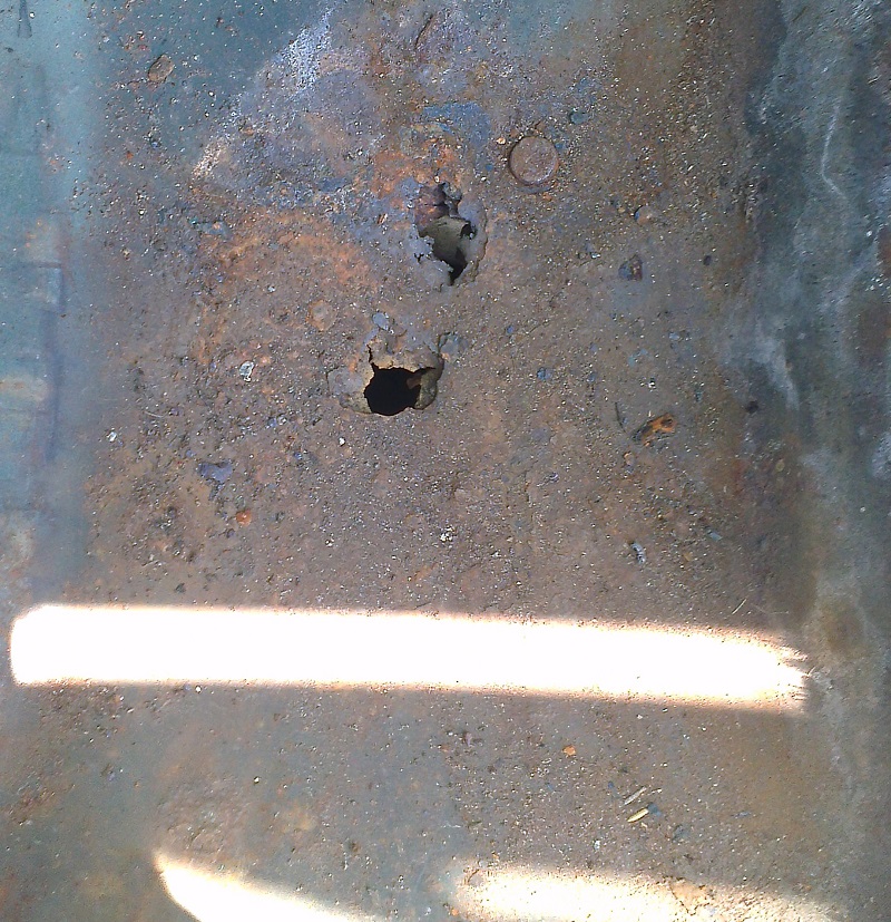

After removing my LPG tank, the rear seats, rear carpets, sound deadening, etc (the sound deadening weighed about 1 million tonnes as it appears to be a tardis for water retention. I am sure that by mass there was 4x more water in it than it should have held.
My boot floor appears to have been made from rot:
(both sides are the same so I am only posting pics of the passenger side as I haven't even started the drivers yet)
So I got busy with the grinder

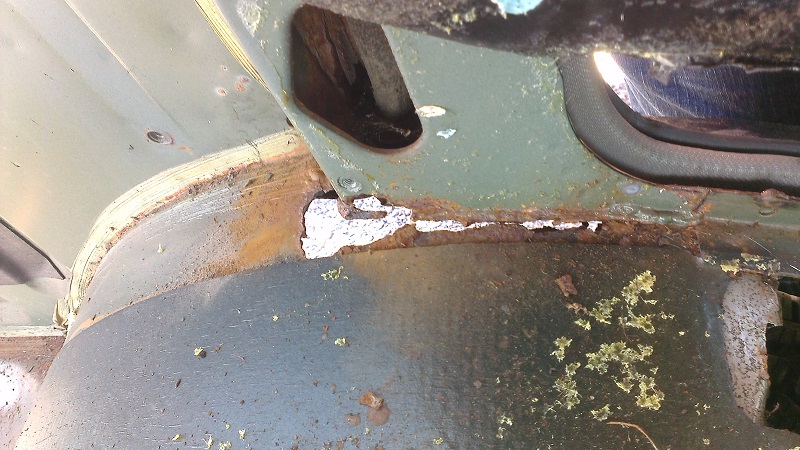

After some poking about I discovered that the D pillar wasn't really connected at the bottom as it was made from rust. I may have got carried away
D pillar1.jpg (180.71 KiB) Viewed 3965 times
On the plus side, I did put some metal back in and start grinding it back before my grinder made a horrible noise and now the motor runs without turning the grinding disc. Not before I cut back the lip of the wheel arch as I tried to remove the rubber so I didn't melt it with welding heat and it took big chunks of "metal" away with it.
D pillar2.jpg (151.28 KiB) Viewed 3965 times
D pillar3.jpg (120.52 KiB) Viewed 3965 times
That was yesterday so I will be going home via B&Q / argos / wickes / some other DIY shop to pick up another implement of metal torture.
Just to note that a cheap metal folder makes fabricating repair sections MUCH easier (no more requirement for a couple of bits of iron, a hammer and a vice), a pillar drill means making holes for plug welds takes seconds rather than minutes.
The only thing I would say is that for more fiddly bits (like my D pillar) a brake would have been damn handy as you have corners in opposite directions within an inch of each other. Also make sure you clamp the metal to whatever scrap you have under it or you end up getting hit in the stomach.
