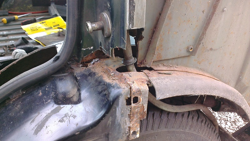

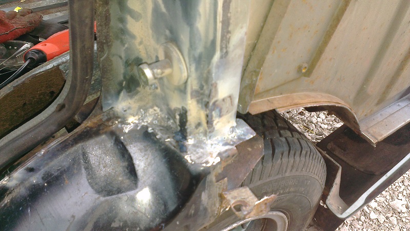

After some poking about I discovered that the D pillar wasn't really connected at the bottom as it was made from rust. I may have got carried away
D pillar1.jpg (180.71 KiB) Viewed 3963 times
On the plus side, I did put some metal back in and start grinding it back before my grinder made a horrible noise and now the motor runs without turning the grinding disc. Not before I cut back the lip of the wheel arch as I tried to remove the rubber so I didn't melt it with welding heat and it took big chunks of "metal" away with it.
