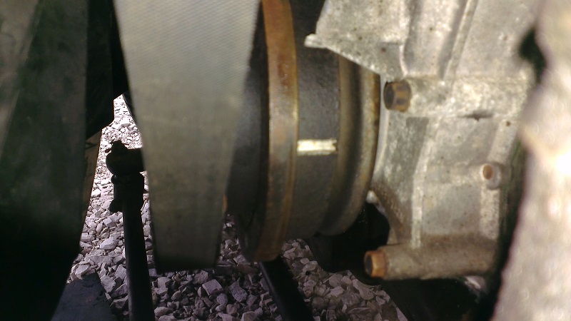

A bit of fiddling today, I turned my distributor round by 180 degrees so I could put my HT leads on the right plug (they are numbered and some were too short with it in the direction it was). Before any silly comments arrive, I removed it, turned the shaft around then put it back in.
I have got a cheapo ebay endoscope which meant I could see why setting the timing was impossible with a light and had to be done "by ear"
This is with 1 on TDC:
The timing mark on my crank pulley is out a tad.
It now has a spot of paint on it in the correct place.

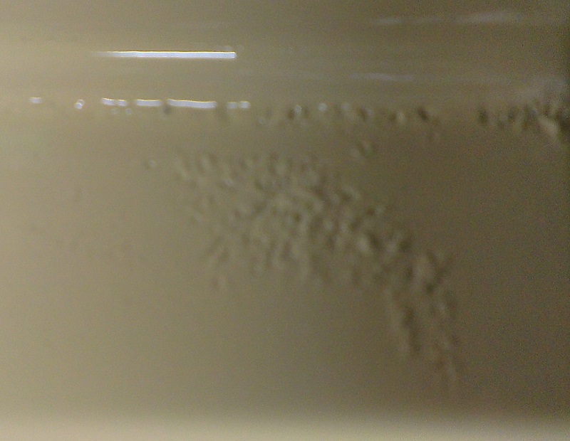

Over the past few weekends I have been prepairing some replacement rear doors for my car as the ones fitted have rotted out at the bottom (it is a common LSE rot spot)
One door is now in primer ready for some nice green paint,
the other has had a paint reaction:
I wiped the area with some cellulose thinners to remove the primer and hopefully whatever had caused the reaction under it and the blue paint underneath came off
I will clean it up tomorrow and try painting just that area again to see what happens otherwise I will have to sand the whole door back to metal.

The other option is to flat it back to the non reacted paint, give it a coat of barcoat then prime and topcoat s normal.
