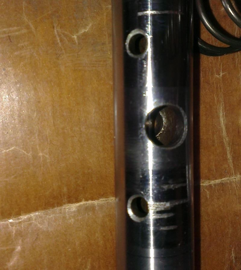

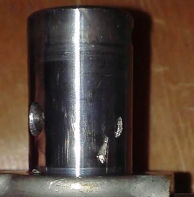

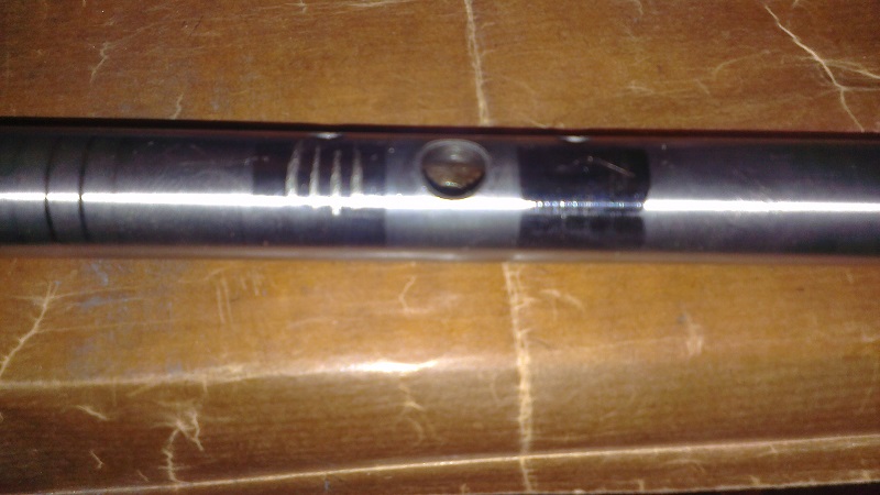

I have taken my old steel rockers apart to see what (if any) bits could be saved to build up a new set. I bought new rockers and shafts and wanted to re-use the springs and pedestals.
Anyway, this is what I found when taking them apart:
inside the rockers themselves, most had bits of aluminium like this
oh dear.jpg (57.73 KiB) Viewed 2113 times
which means that the shaft looks like this
and this
The scoring is up to 1mm deep in places. The ends of the springs are all but destroyed with deep pitting as is the face of the pedestals. After cleaning up the face of the rockers where they press on the valves are all badly scored and pitted too. I am not very impressed!
Fortunately I have a second spare set of rockers which 154,000 miles on them. After cleaning the crud off (the previous owner was not a big fan of oil changes) if I didn't have new rockers, I would happily fit them. The pedestals have minimal wear, the rockers have a polish where they have been in contact with the valves but nothing major and the springs are like new so my steel set is going in the bin and I will build up replacements based on the ones from my original 4.2.
