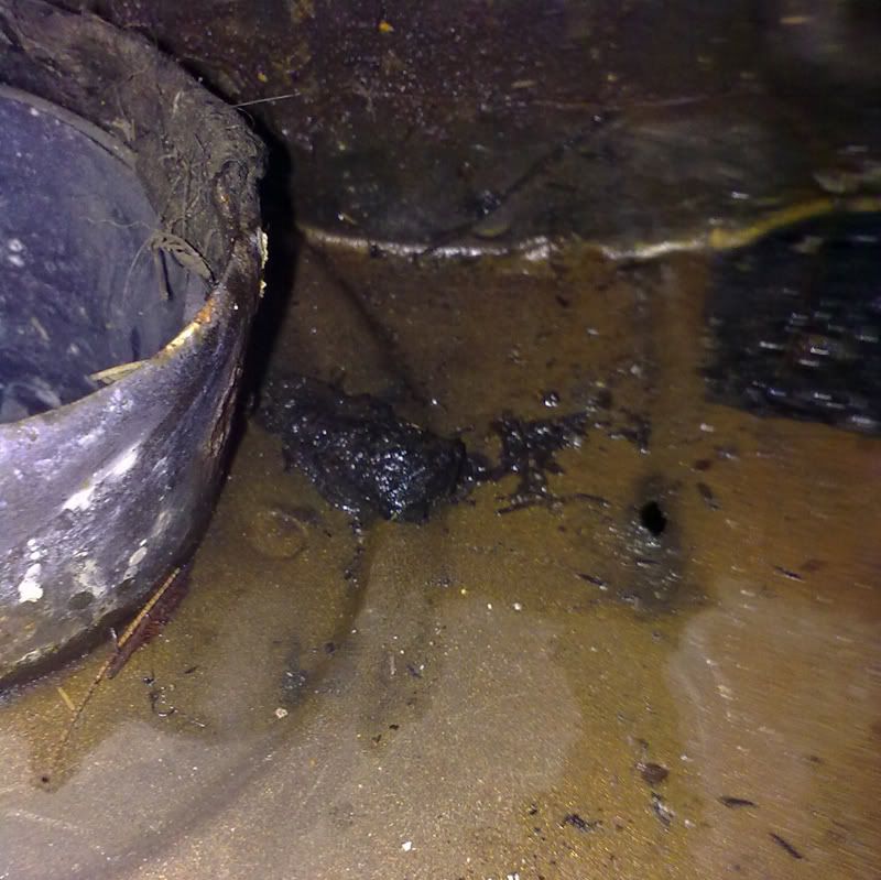

glad you found one of the faults
Re: 1994 Range Rover
If you count each trumpet as a fault then there were 6 not seated properly / at all. If you look at the first pic you can see wear marks on them where they have been vibrating against each other.
any idea what caused them to come loose?
No idea, they are supposed to require heat to insert / remove them rather than a gentle tug. I have added a replacement plenum chamber to my autojumble hunting list. hopefully I find one for not very much money.
