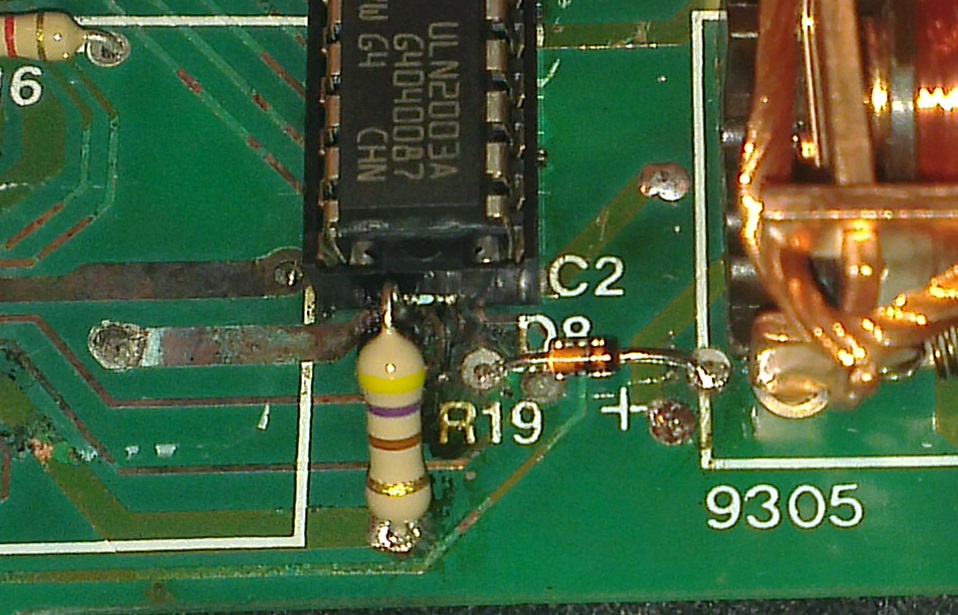

A few pounds (for enough parts to fix 10 of the damn things), 20 minutes with a soldering iron, some scrubbing to get as much "burn" off as i can and.....
TADA!
The PCB itself is black but all the tracks are good. Fingers crossed it works again! I collect the car back from the MOT place tomorrow (hopefully with a new ticket) so will test it then :)

Well, I'm moderately irritated. My repaired ECU doesn't work :( I have compared every line local to the damage with my other ECU and they match so definitely not a problem with the PCB itself. All the relays test OK. After a really close look, there is a small black mark which is just visible under the "computer" so I suspect that it may be scrap :(
On the plus side, my spare "faulty" ECU is now repaired and working fine so I can adjust the seat again. Just as well I didn't think about fixing it a few years ago as I would probably have sold it and now I would be stuffed!

Oh well, still a good result if not the one you'd have preferred. Hang on to the faulty ECU though, you might find that the chip can be replaced at sensible cost and the unit then sold on as a working one. :)
Re: 1994 Range Rover
Posted: Wed Nov 27, 2013 11:55 pm
The broken one will take residence in the box where the "faulty" spare has lived for the last few years. I'll keep my eyes out for another faulty one as normally the problem is a leaking battery eating it's way through a load of tracks on the PCB. The "computer" is far enough away not to be affected by that so I should be able to make one good one from the two.

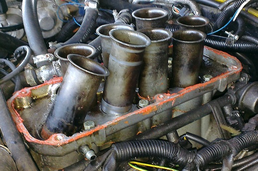

I have taken my intake apart in search of the cause of poor idle when hot.
Looking at these, I may have found it
One of them has rattled loose and was so high that it was rubbing against the top of the plenum chamber!
I was able to pull all 8 trumpets out (not difficult as 3 of them weren't actually in!) by hand, no heat required so I will put them back in with some liquid gasket to hold them in place after I have given everything a good clean.

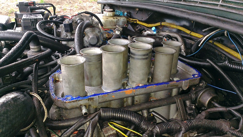

It looks a bit better after a good clean and having the trumpets epoxied in place.
