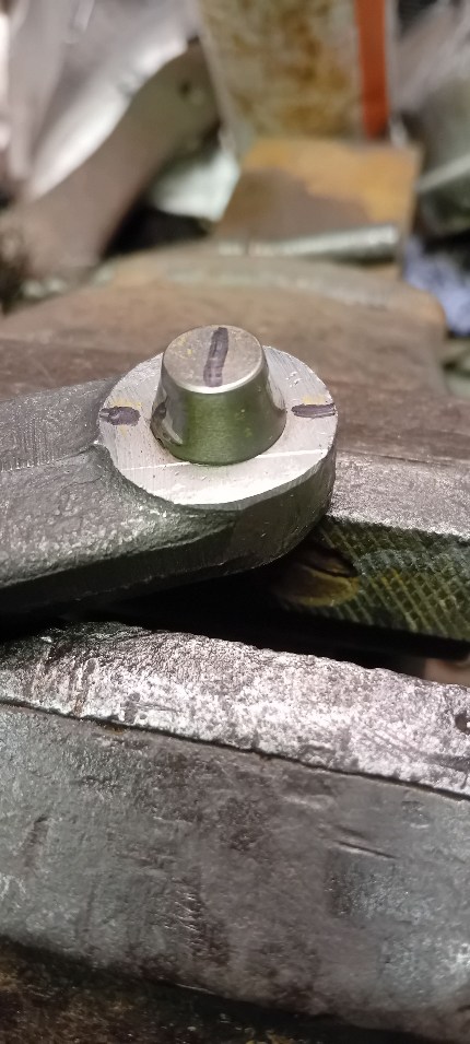

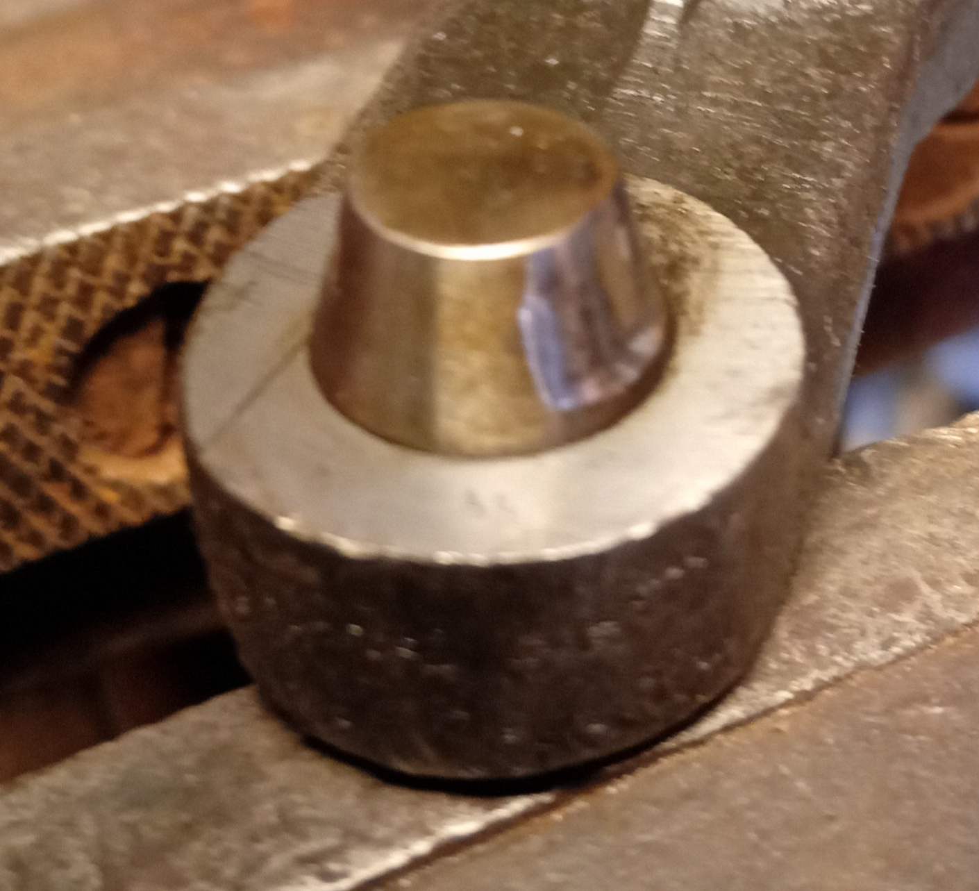

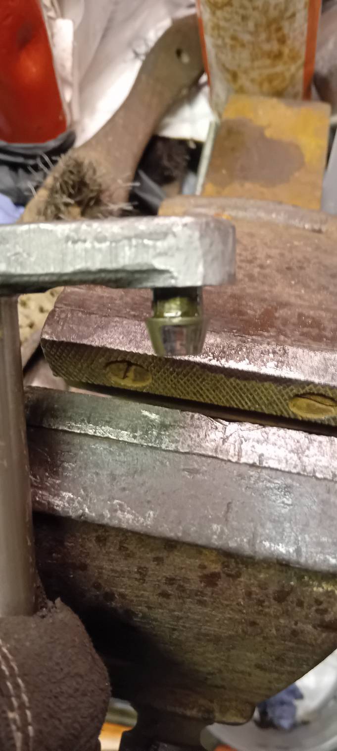

Pair of new seals arrived today and have been fitted to the idler and steering box. I rebuilt the idler and filled it with EP75/80 and it's now standing upright to see if the oil weeps past the seal. It should be EP90 but it what was in the garage, and I assumed if the thinner stuff stays put, EP90 should too.
I also drifted out the cam gear pin. This had some wear and showed up as a small amount of play.
Wear on steering box pin
I started with a 1lb ball pein and soon replaced that with a 4lb club hammer which worked. Then put it back turned through 90 degrees so it runs in the worm gear on the unworn faces.
