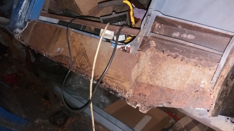

I've seen a lot, lot worse ... and being used on the road!!! I agree given it's age it is pretty solid. The worse two areas were the outer sills and they are in the process of being replaced.
This is what I found when I started to pull the rusty bits off .. and they didn't take much pulling. There was even a section of blue plastic sticky-backed tape covered in Isopon. That part with the round holes? The jacking point support :shock: The jacking point (a metal hoop welded to the sill) was actually missing on this side
Outer sill from below .. oh, missing a bit!
Some time later once the grinders had been at work ... I have some rust-converting to do .. Hydrate-80 at the ready!

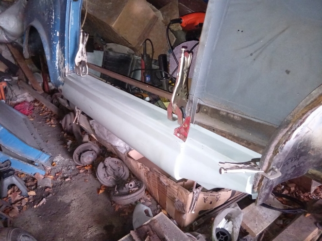

And the nice new metal being lined up and tweaked to fit ...
Aligning new sill
Aligning new sill

So those pretty new sills ...
They don't fit .. :roll:
The measurements are all over the shop compared with the original sills. Am awaiting a chat with the supplier this coming weekend. At the front there is about 1/2" gap between the edge of the sill and behind the lower a-post flange that is supposed to be spot welded to the sill, the curve is too pronounced and wider at the centre, meaning tge doors are unlikely to seal or even fit, and at the rear they are too wide and don't sit flush on the old panel edge. Good job I only cut one off!!! The nearside is the same but as I have the old intact sill in place I've been able to provide the correct measurements.

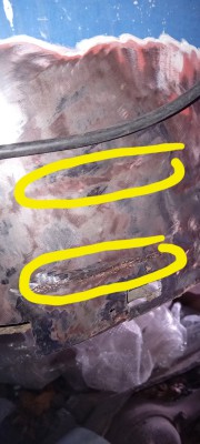

Cut out a couple of small areas of the worse rot and made up a couple of patches to fit:
I also found a couple of deepish long dents on that lower wing which were hidden under a very thick coating of 1960s era filler. They have now been pulled out with a small slide-hammer after about a total of 8 holes were drilled along their length:
On the nearside it is just a crusty area about the size of an old penny which I should be able to cut-out and patch from behind. There is also a bit of damage along the bottom of the rear panel where a valance used to be mounted. Said valance met an unfortunate end when the car got bumped and the bumper was pushed in and the valance crushed. It was removed using a bolster chisel so left a bit of an untidy mess under the filler. That will also get sorted.
