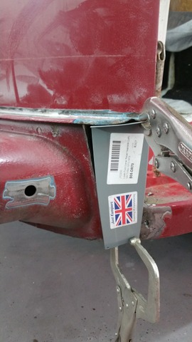

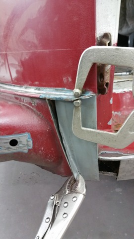

That are manufacturing & retailing poor quality parts to the classic car market - This is a repair section for the VW bay window camper that I currently working on
proudly applied union jack / made in UK logo - no where even close to fitting - I have had to alter the flange and I will still have to piece a section to it to make it good
I think we have got to the point where a national quality standard for classic car parts should be instigated but how it could be applied and policed is another thing

That extra gap is for improved ventilation ;)
Is it the new panel that's pants or the existing panel on the van?
Existing panels on the van are original so it's categorically the replacement panel that is the problem

That sucks, I've never worked on a dub, is it a compound curve or a panel you can make yourself without too much difficulty?
Re: It's not just the far east
#9 Post by Grumpy Northener »
Terry - It's a compound curvature panel - they were £9 each and I thought for the money that is was not worth me messing about making up the panel from scratch although I could have done - I am going to have to spend as much time altering what they supplied to fit now - I always expect a little bit of adjustment with new panels even OE stuff rarely fits without some modification but these are nowhere near - I shall certainly be advising the supplier of the failing
#10 Post by TerryG »
That sucks.
I feel your pain with fettling panels, I don't think any off the shelf ones I bought for the RR were the correct size / shape and all needed some modification to fit.
