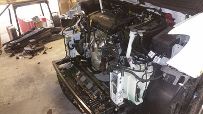

Compare it todays built cars and its a complete revolution - I say this because for the first time in 30 odd years I have just accident repaired / replaced a front end on a modern - and it really is simplicity - most things are bolt on - there is a awful lot of plastic but it is all there for reason - having completed the repair I have to say both from a practical and impact energy absorbency todays vehicles have never been better built - so rather than have large lumps of metal fold up and in doing so carry the force of an impact into the vehicles cockpit - the metal panels are of a thinner construction that fold but absorb the energy of the impact rather than carry it through into the cockpit - with a large part of the front bumpers / frontal panels now all being plastic and all absorbing the majority of the impact energy - couple this with the multiple air bag & seat belt arrestors along with ABS, side impact protection systems that we find in modern vehicles of today and there is no doubt that vehicle cockpits have never been safer.

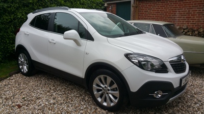

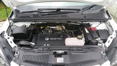

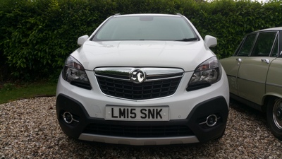

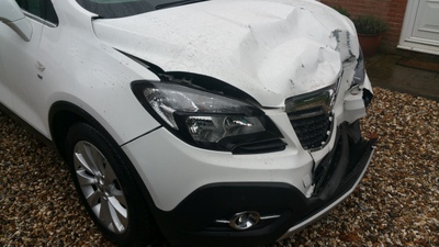

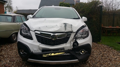

So case in point - I was recently in the market for a newish modern and managed to purchase this unrecorded damaged Vauxhall Mokka - less than a year old and a few thousand miles on the clock at a sensible price
All panels / parts were bolt on and was not very long before the car was back together.

Ah - now I didn't say that they are that cheap to repair but it helps if can buy the damaged motor in question at the right price - secondly it helps further if you have the right contacts in the trade that can apply some genuine and meaningful discount on the supply of OEM parts (the Vauxhall was repaired using all new parts) - nothing used - I just managed to have a good contact in a Vauxhall dealers that has a pricing strategy in order to supply the parts at discount rather than loose the sale to the spurious non OEM or breaker / second hand market - and thirdly it very much helps if you undertake all the work - including the paint yourself - which I did with exception of the air con regassing.
Now the reason that most new motors get written off in moderate shunt - well a front end on a decent family car with outer panels / trim / rad pack / bits of plastic / labour / paint / recovery / specialist services (electronic diagnostics / air con regass etc) hire car etc starts at circa £5k minimum and creeps upwards depending upon brand pricing / parts pricing / so for example outer front end - a few structural members / trim etc on a Mondeo front end will be circa £6 / £7k - but hang on the air bags have deployed so it needs a new steering wheel centre - new dash - seat belts & seat belt arrestors - may be the seat air bags or the curtain side air bags have triggered - so that's new seats & curtain bags (which wreck the headlining upon deployment) and you have another £6 / £7k on the bill - so 18 month old Mondeo with 15k miles - new was £20k - used value now £13 / £14k - there is good chance that it's a write off with the above damage as it will take a month to repair and the hire car costs rack up daily - and this is the reason many newish motors get written off / broken.
That said, Chris was, IMHO, a right jammy bugger to find a modern car whose suspension attachment points and other shell data were either able to be teased a little or hadn't moved at all,
- Well all moderns lack structural panel work after the suspension mountings nowdays - inner wings are just lumps of plastic - the whole front panel / bonnet landing panel / rad mounting / bumper on a new Fiesta is just lumps of plastic - its just two rails / chassis legs with a bolt on cross member on collapsible metal mountings - most moderns are primary all plastic for the first 400 / 500 mm of the front end - the Vauxhall I repaired had no structural damage - no suspension damage - but the anchors had been firmly on when it hit whatever it hit - has I had to replace both rear tyres which had only done 4k miles due to heavy flatspotting !
