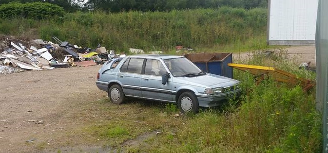

There's a bright orange 1979 Vauxhall Carlton on eBay just now, its listing is illustrated by the usual variety of images among which is the one I've attached below, which shows the R6's long lost sister, just thought that this was sufficiently interesting to post here, my apologies if my R6-related joy should ideally be elsewhere than in this build thread:
Note the similarity between the registrations of the pair, different yet close enough to be mistaken by someone who sees the blue one after having consumed a quantity of fine Guyanese rum since last looking at the one featured in this thread! :oops:
