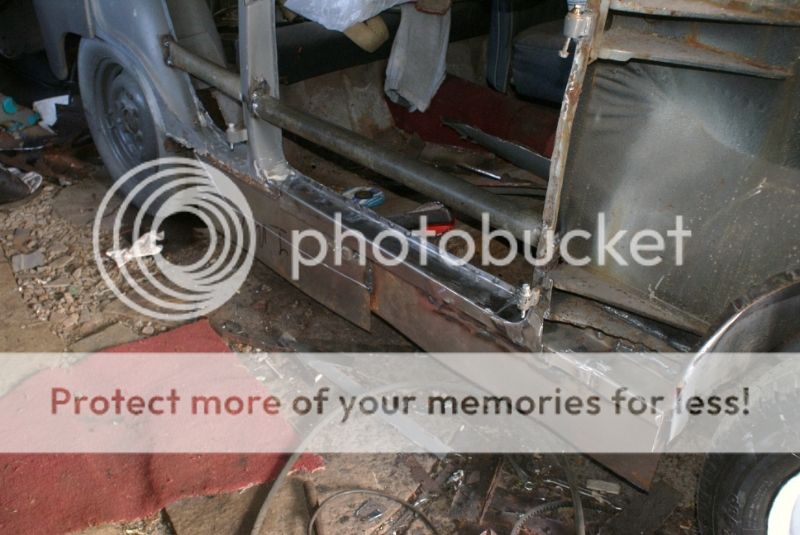

I braced across the doors and cut away all the inner sill and outer sill leaving just the rear door step. Then started adding a bit of steel, all the lower edges of the vertical pieces are longer than needed because I'm not yet sure where they need to be cut as what was present was not correct.
So some good steel and strength now in place along with a new section I made for the A post to sill
Tonight I replaced the step section of the rear door opening and then decided it was strong enough to remove the bracing, I'll add photos of that when I next update.
I'm now waiting on a cover sill arriving that I hope to chop about and add metal to in order to make up the sill proper, plenty to peck at while I wait for its arrival but I'd like to get the sill area finished.
