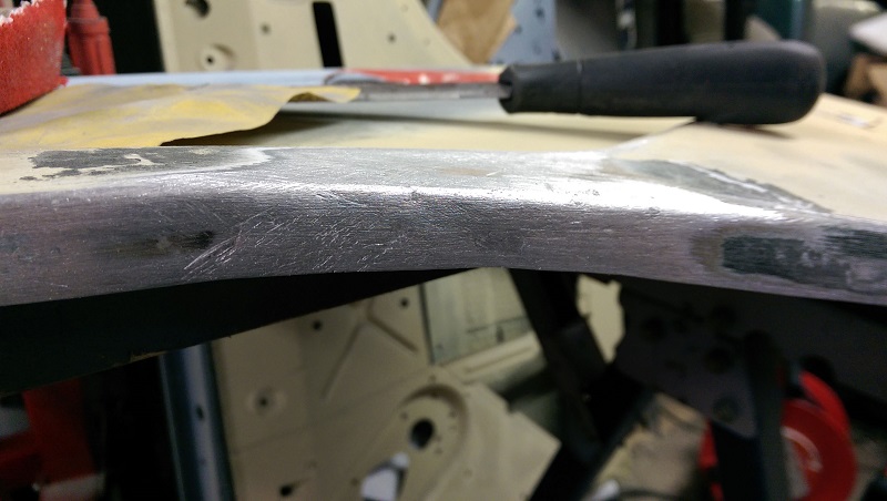

OK, I am 25 minutes late.
This is what the outside looks like after yesterdays filing down of previous attempts. Plug welds after 2 minutes with a file This is what the inside looks like. It needs some serious cleaning up which i will do with a grinder at the weekend then i can prep the wing for paint. Blob tastic but damn solid!

Re: Aluminium welding with a MIG
Yep, that works for me! Just be careful when you use a grinder with ally - wear that mask!
