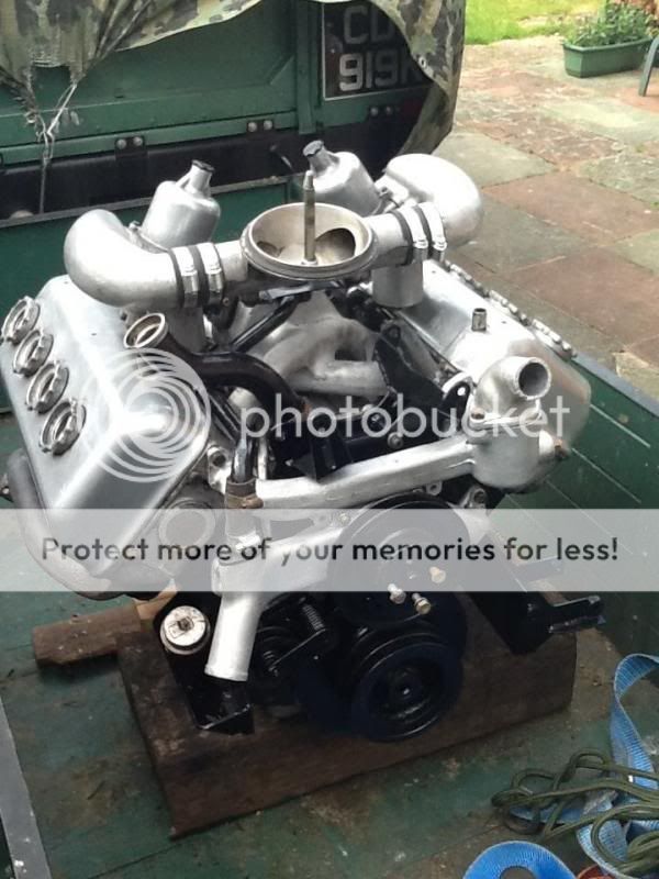

hi there dave
many thanks for the info the rebuild went very well and I encountered limited problems. I also suffered from water way damage to my original heads, on eof which was beyond repair. I did however obtain a pair of replacement good quality heads from Mathew at the daimler and lancaster club (thanks mathew!!) and also a full low milage donor engine from James at the same club. armed with this I had no problems building a good quality replacement unit. I was thinking of replacing the oil filter with a screw on number where can this be obtained from?
here is a picture of the finished engine awaiting transport and its dynamo to be installed.
cheers
lee
cheers
lee
