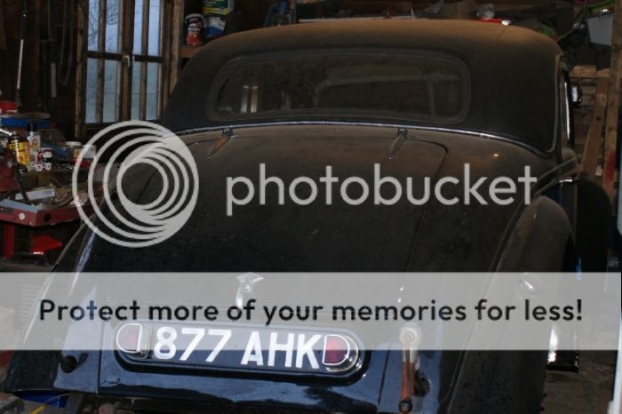

I can't show much here as Rusty is still stuck in the garage on a jack waiting for me to replace the last wheel cylinder. When I get round to that I will get her out and cleaned off for some decent photos, and I'll get the chance to get rid of the debri that has yet again gathered all around her.
I rectified the worst of the microblistering that I mentioned a while back before getting slowly back on, though other matters have been keeping me from her we have still moved forward a little.
Definately in need of a bloody good clean off, we had strong winds today that brought on one heck of a dust storm off the neighbouring fields, it was like being sand blasted when you stepped outside, the garage door was open when it hit and the result can be seen all over the car.
All 4 wings are now in paint and on, both back doors are trimmed up, spare wheel cover is done and on.
Started on with the last door tonight but its the worst of the four so will take a bit of putting right. Whilst I still have the "sills" and the front number plate panel to sort the door is the last big repair body wise that stands between me and a test run, so I'll be glad when it is done and on.

Noticed from your picture you are using the original jack.
A word of warning - they are prone to sudden catastrophic failure. They seem to break or separate in the tube and cannot be repaired.
I put mine in the boot working and on lifting it out it had broken! On investigation sudden failure is very common. I am just thankful I did not have the car up on it at the time!
Be very careful and use an axle stand with it.
