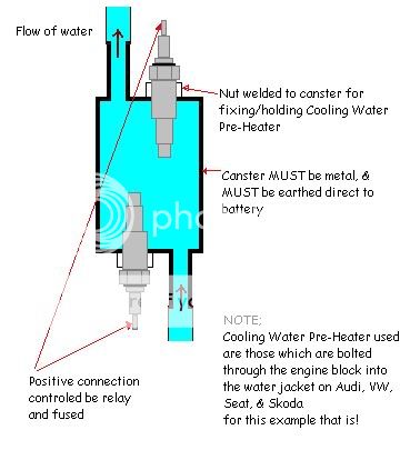

Has anyone got an engine pre-heater installed on their vehicle?
if so was it off the shelve jib or a home made set-up?
Such as a block hester which replaces one of the plugs in the block.
Or a on which is in the radiator coolant hose.

Hello , a manufactured one in a radiator hose, it's now 40 years old. Personally there is no way that I would contemplate a home made one for safety reasons.

I was thinking of something along these lines.
http://www.ebay.co.uk/itm/Audi-A6-1-9TD ... 1e615220f7
And as it is already 12v and about 60 Kw/90 persecond.

Just get a Webasto heater, less Heath Robinson, although you will need a seperate diesel tank if fitting to a petrol.

EErrrr no space for yet another fuel supply, hence the 12v option.mach1rob wrote:Just get a Webasto heater, less Heath Robinson, although you will need a seperate diesel

Where are you going to fit the big battery you'll need to run these? If they are 60W, it'll be like leaving the headlamps on! Then, of course, a larger alternator will be needed to keep the big battery charged up!
I have a similar problem with my Golf - if it's left outside, it takes six or eight miles before the engine is up to temperature on a cold winter's day, three in the morning - the car lives in a garage! However, I won't be fitting any extra heating (it would be a mains-powered one if I did) and, to be honest, I don't think there is really much of a problem with cold oil - so long as you use a good brand - after all, lots of cars are left outside and never get really warm in winter. I can see the problem with LPG (older tractors used petrol for starting and then changed to paraffin/kerosene, which needed a hot engine before changing over), but wonder if the extra cost and complexity is going to save a massive sum of money.
I well remember the winter of 1963, when wagons used to park up in Carlisle (near a filling station) and they used to put newspaper under the sump and set light to it! Perhaps you should NOT try that trick!
