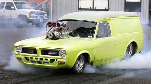

How about an engine on steroids? Or could that be hemiroids? You might have to knock the bonnet about a bit, but the end result might just kick ass, as our friends over the pond say.
marina van.jpg (23.49 KiB) Viewed 23382 times
