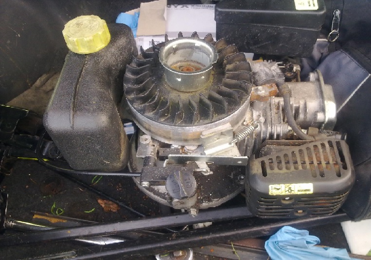

I have also managed to get hold of a complete 2 stroke lawn mower to use for some spares just in case.
It has as you can see had the rest of the lawn mower removed. The head has been off & piston freed.

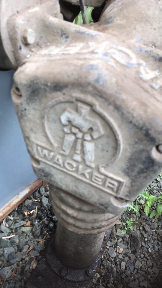

As you can see it looks like a bit of overspray on the id tag means it was overhauled sometime ago.
