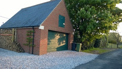

Is exactly what it is - a project to sort out my workshop - it was built by the previous property owner also into classic ownership and although it looked ok on first appearance it very much like the house therefore I have branded the previous owner as a 'unfinisher / bodger' has everything is either unfinished, bodged or a combination of both
It looks great and is built pretty well with a matching slate roof with a 50 degree pitch to match the house (which is an old chapel)

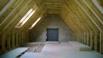

The added bonus of a loft space but has you can see unfinished with a lack of floor boarding (now completed) and crammed to the rafters with everything that SWMBO wants to keep just in case of a nuclear fallout (99% of which is useless but she insists on keeping it)

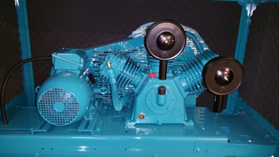

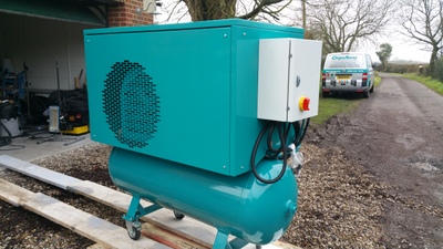

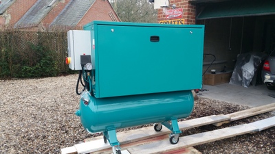

I needed a compressor for the workshop - whilst there is a vast range of off the shelf kit available - nothing suited my requirements - I wanted to future proof my capital purchases - hence although 150 litre 14 cfm (cubic foot per minute) compressor would suit my needs now - it highly unlikely that it would be of sufficient capacity in 12 months time so after much research I found a company that would custom build to my requirements and the end result is this
270 litre - 23 cfm - however to power a pump of that size the motor requires a 3 phase supply and I only have a single phase supply - so the motor is powered via an invertor - I also had an acoustic canopy made for it which takes the 101dba down to a much more acceptable 68dba - close the garage door and you cannot hear it running outside of the building - I have great neighbours and would hate spoil the relationship by creating nuisance noise.
Has you can imagine custom build + future proofing comes at a cost - £3,500 cost ! :o - but I am of the opinion that I want to do it once and it's pointless investing for the short term when buying professional equipment - I had the compressor mounted on industrial casters so that it be moved in the workshop if required - I now have it plumbed in with feeds to 2 wall mounted self retracting 15 metre reels - supplied air initially via a 3 stage separator with coalescer to provide breathing air for the air fed mask.
