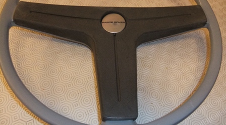

one of them ,I think the grey is wrong ,needs to be darker .
Re: steering wheel
Posted: Thu Apr 14, 2016 7:58 pm
Is that grey a result of exposure to light or has someone painted that wheel in its past?
If it has faded it's definitely a modern, synthetic plastic such as polystyrene or ABS. A quick web search for "Retrobright" will explain how, using a mixture of some things that are almost always present in a kitchen, these plastics can be freshened up massively and that may be enough but, if you need to paint the wheel, then enamel, thinned by >50%, will be the smoothest way to go. Each coat will need a day to harden sufficiently to consider giving it another coat, so it is a slow process compared to using acrylic paints, but will ultimately be both harder and smoother than any modern paint.
If the wheel rim has nibbles, deep scratches or is down to the wire at any point, then use Miliput or a similar polystyrene-based filler to build up the shape. In the event of there being any cracks that appear to be more than skin deep (IE, when the parts at either end of the crack are moving relative to each other), then grind down until you reach solid plastic or the rim wire and build up with the modelling putty/filler to shape. A profile gauge is worth using on this sort of task and will have other uses - automotive and household - after the wheel job is finished.

its been painted in the pasted .
now this one is the right colour ,I repaired it , cracks etc, primed just need the right top colour .
wheel 1.jpg (8.5 KiB) Viewed 5183 times
