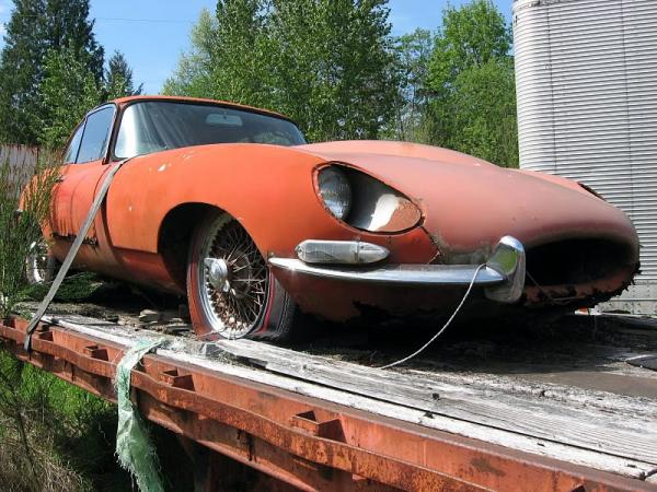

Id be tempted to say Metro too or Ford Escort Mk4 or later, Renault 5, mini , minor or anything that, like you say, the parts are still available for. There is always the E type Jag, now that would really test your welding skills and all the repair panels are available from SNG Barratt or Martin Robey :D

Heralds are great. E-type for the experienced only. Metro's and Escorts are what I cut my teeth on. Fiat Chinqueccento ( ????) would be a good idea. But dealing with rusty old junkers is the best way to learn the art of restoration.
