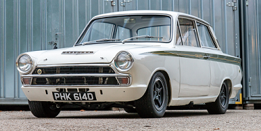

Wanna make friends at the Goodwood Revival? Show up in this: a 1966 Cortina prepared by Team Lotus and driven by Jim Clark, Graham Hill and Jacky Ickx, among others. As classic touring cars go, it's about as special as it gets, which is why Silverstone Auctions expects it to sell for £200,000 (roughly $255,000) at auction.
