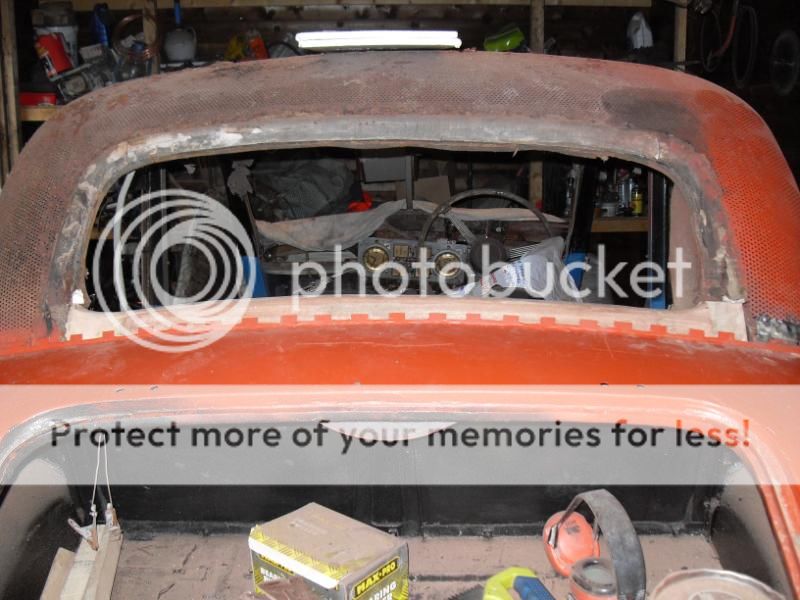

A good poke around showed the top rail and nearside sections to be sound apart from a little bit of the joint edge on the nearside vertical section, so I decided to keep these. I then removed the drivers side vertical section of the frame and made up another. Sorry for the lack of pictures, but I forgot to take any :oops:
Anyway, both sections were fitted and glued, then the edges of the roof were tidied up along with some freh metal let in. The perforated roof has also been given a good wire brush and a thick coat of hammerite.

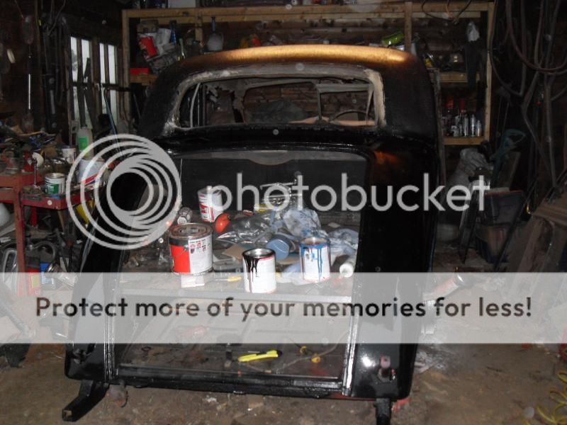

This done the body and roof were screwed to the timber frame around the rear of the car, and a start has been made on the paintwork, grey primer, followed by a couple of coats of gloss which now needs a gentle sand and a couple of finishing coats.
This is how she stands now

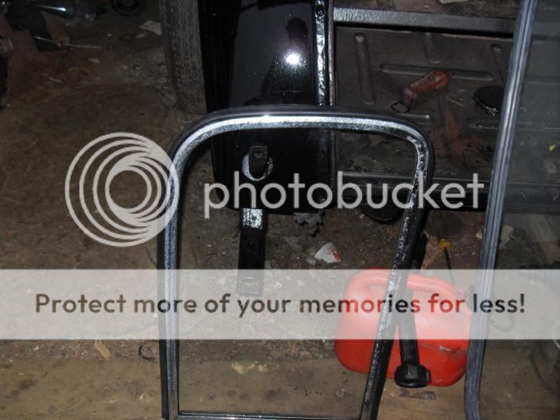

I've bit the bullet and bought in the proper roof kit along with front and rear window seals, once the seals are all fitted to the windows I should be able to get on with covering the roof.
Two windows down, one to go, the fronts are a little awkward.

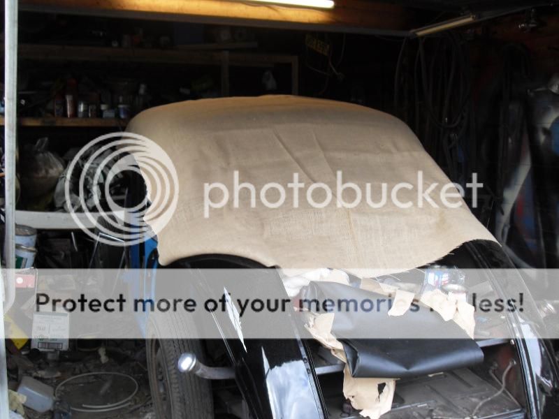

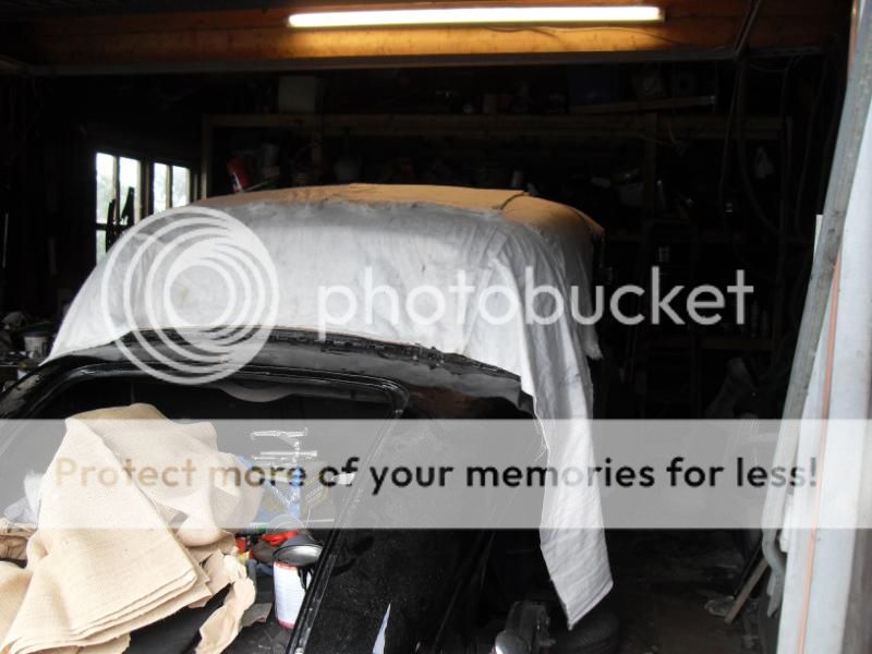

First a layer of hessian is draped over the roof

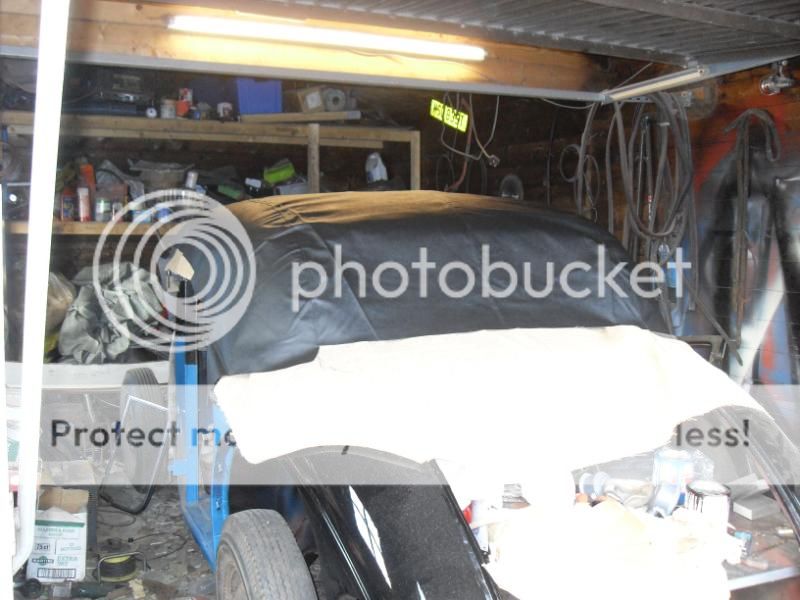

Which was then covered in strips of wadding
The Everflex Vinyl roof then goes over this making sure not to ruck up the wadding as it goes

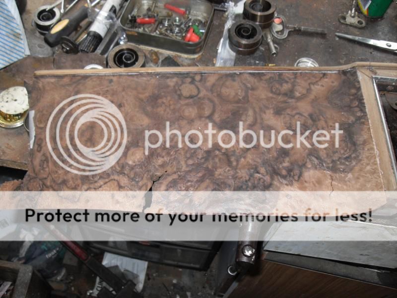

The dashboard was a mess of peeling veneer when removed from the car so I stripped the offending stuff away and have replaced it with some fresh veneer of the same burr walnut.
New veneer going on
Trimmed
I'll post pics of the finished article once varnished up.
