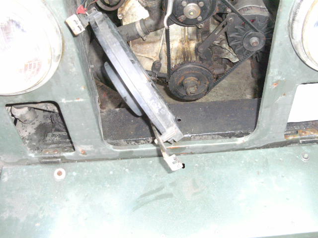

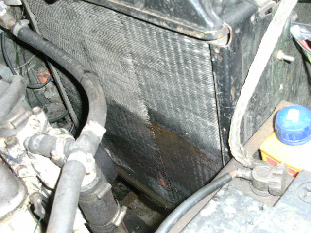

I have been on a shopping spree, firstly the radiator on the landie sprung a leak after the kids spent an afternoon driving it around some fields, so after parting with 115 pounds I have this to fit.

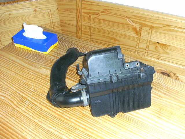

Secondly I have bought a proper airbox to replace the k&n on the mx5.

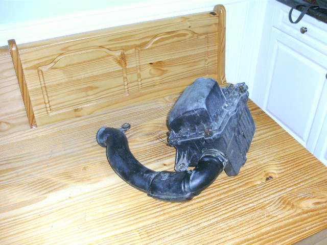

been playing with the Mazda today, firstly cleaned up the airbox in the dishwasher.

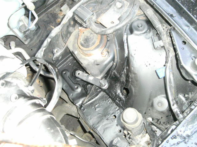

but before I could fit it I had to look at the rust patch, I cleaned the area up and it and the root cause is the front 18" of the car has been replaced I assume after crash damage, It is in front of all the engine and suspension mounting points so not really of any major consequence and appears to have been done very well with a series of neat but welds. The problem is to make it invisible they have covered both sides in filler, in time moisture has got into it and begun to rust the metal, fortunately there were only a couple of tiny holes which welded up easily enough, the rest was mild surface rust which cleaned up easily with a wire wheel , so it has now been primed with zinc rich paint and sealed with seam sealer, next step will be stone chip the underside and tidy up and topcoat the upper side, later in the year I will be waxing the whole car. On the good side I cant find any other rust (pretty rare for one of these) and I have also noticed it has bilstein suspension.

Had 3 or 4 hours today, firstly I painted the area I had repaired on the MX5 with stone chip, the engine compartment side will need rubbing down and top coating eventually but to make this look good most of the inner wing will need doing so this will have to wait, as shown n the picture is the welds with brush able seam sealant and then black stone chip.

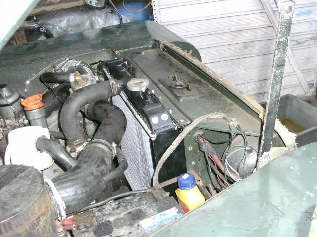

Then I fitted the land rover radiator, this was made difficult by the electric fan which uses the same bolts, I had to cut some metal off the brackets to get it to clear.
and some of the holes did not line up, if any one else is doing this I would recommend enlarging all the holes by 1mm before you start to give a little more room for manoeuvre.

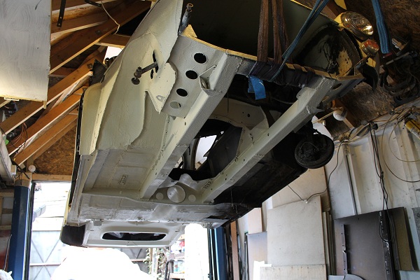

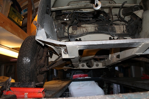

Managed to stone chip the repaired areas under the minor and re-fit the suspension temporarily so I can move it off the ramp and get the TR out.

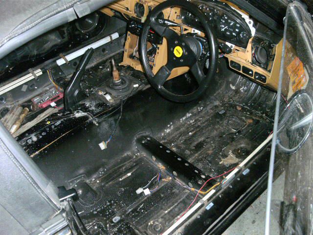

The bearings have not arrived yet so I have been playing with the cars, the focus has been pulling the trim out of the mx5 to vinylkote it so all the colours match.
The good news is the spotless floors, not bad for an 18 year old car (the brown marks are leaves)
I then noticed a mark in the transmission tunnel, closer inspection revealed a 2 inch long crack!
So I had to crack the welder out, fortunatelly welding a small crack in sound metal is a lot easier than patching rust, picture shows it welded up, I made the weld quite wide to make sure any cracks around the edges were covered.
The carpet is also now in and looks much better, hopefully the colouring will be done by the weekend.
